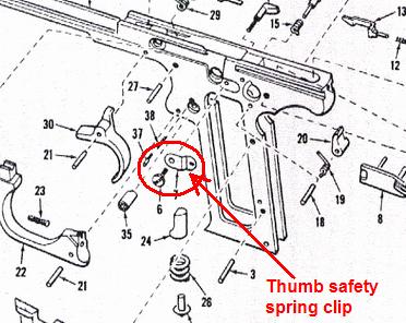

I have this love hate relationship with my SW 41. This gun groups well for me, but often times when I am expecting the gun to go bang it does not because my grip is high in the web and the safety has been pushed up. This causes my attentional concentration on the dot to be disturbed. Now I have to think about something else, why isn't the gun going bang. I have heard that others have had this problem with the 41. This problem causes me to loose points in my bullseye matches. I do understand that there must be a functional safety on the gun so I can't make it less than functional. How have others who have had this problem solved it apart from selling the gun and getting another that does not have this problem.

I sometimes have (had) the same problem with my 41. The solution, at least for me, was to check the safety was off AFTER I got my grip. The safety on mine is hard to move but I unintentionally hit it sometimes with the knuckle at the base of my thumb and flip it on and I wouldn't notice it or feel it go on. Just get in the habit of checking to make sure it's off with your non shooting hand after you pick up your 41 and get your grip. Once it's off you should be fine.

Posts: 647
When I was still shooting Model 41's I had the same problem. My grip was so high on the gun that I would engage the safety right before a string of fire. Result- alibi after alibi. An old gunsmith provided me with a quick fix which stiffened up the safety enough that it would no longer engage just as a result of my grip. However, the safety remained fully functional.
One can find a good explanation of the fix, here:
(12th post down)
http://www.rimfirecentral.com/forums/sh ... p?t=276931
The instructions I was given state to remove the clip and bend it slightly downward.

m1963, thanks for the suggestion. It worked. I shot a match today no alibis.

I had the same problem with my 41. the safety has a small detent stamped into it. I removed it and judiciously
used a small pin punch to reset the detent. 6 months later it is still good.
