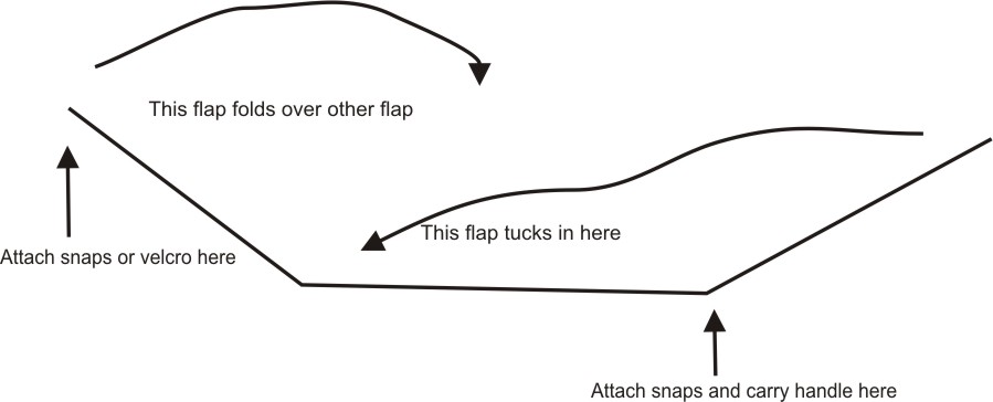

I documented the process and have uploaded the file to my website for you to enjoy:
http://williamdutton.com/How_to_make_a_ ... ne_Mat.pdf
How to make your own prone mat.

Then fold it over and sew around the edges. Only problem is heavy tarps or canvas are tough and the seams are thick. Again the boat canvas (or maybe upholstery place) has the big sewing machines that work. Old metal singer sewing machines work great and are almost bulletproof. Be VERY careful with cheap sewing machines and think material. The gears in these machines are made of plastic and if you sew something to thick you will break these gears and it's a pain to get them fixed and you will get yelled at. (don't ask me how I know) I'm going to put together a little diagram to show how it's made. I've had better luck with flat folding ones that round rolled because it stacks better. The kids seem to keep these neater.
