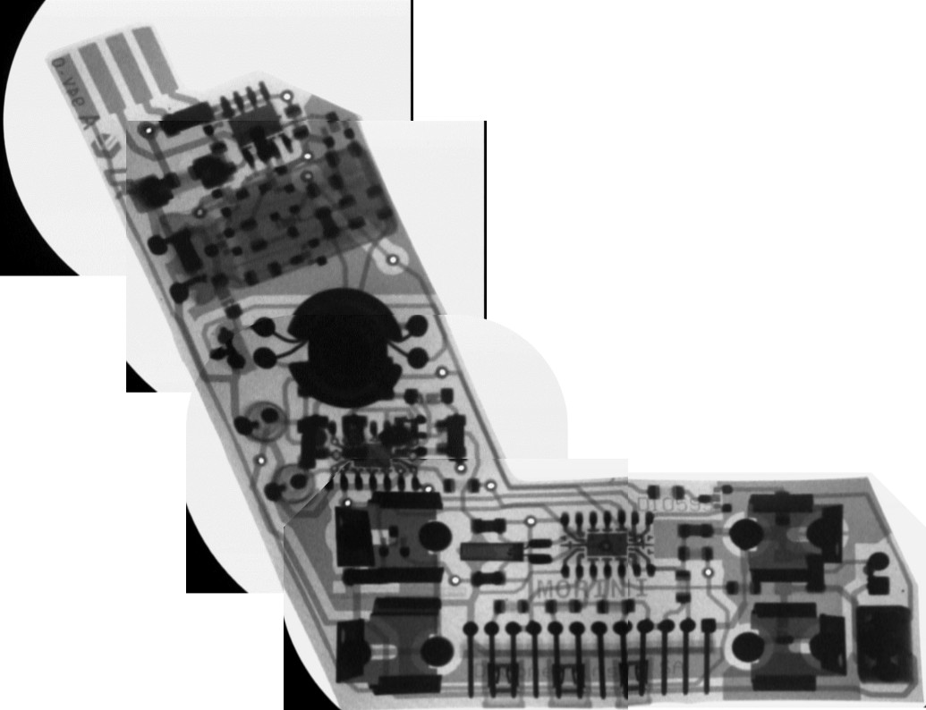

Just for fun and reference here's how a right hand module looks like inside.
Posts: 3584
Thanks for all the advice, and the great photo. I was actually thinking of taking one in to work where they have an X-ray setup, but you saved me the trouble. I'll have to study it carefully. So far all I can tell is that it looks like they are using a transformer for the boost converter to charge the main cap.
