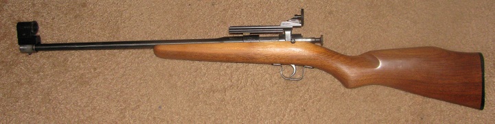

I thought I'd report back and say that the setup with the Williams sights is a success. I bought all the parts mentioned in the previous post. Everything mounted to the rifle with relative ease.
The 1/4" pipe coupling was drilled out with a 1/2" drill bit. Apparently the barrel is tapered slightly and it wouldn't quite slide all the way on. I used a 9/16 bit to drill out about 1/8" which then let the adapter slide on so the tip was even with the barrel. One hole was drilled and tapped in the bottom for the set screw. Two more holes were drilled and tapped in the top for 4-40 screws that were bought and cut to fit for mounting the .450" height dove tail adapter. The adapter came with metric screws and since I don't have any metric taps (hence the 4-40 screws) I didn't use them on this part (but the screws came in handy later.)
The target globe slides right on to the .450" dovetail adapter and is easily taken off to have different inserts installed.
The receiver sight slid onto the dovetail stationary mount base with a little effort. The downside to using the WGRS-54 sight is the 1" diameter target aperture hits the base of the sight about half way up the elevation. This wasn't a big deal since it does allow the sight some elevation. The whole stationary mount base and receiver sight assembly had to be elevated about 1/4" above the receiver. That's were the long metric screws from the .450" height adapter came in handy. I used a shim to hold the base and receiver sight assembly in the correct height and the screw was then the correct length and thread size to fasten the assembly to the top of the receiver.
I still need to do a little more work. The globe inserts aren't quite the right size to get the best sight picture on the target bull. Unfortunately, Williams doesn't seam to make any other inserts besides what came with the globe. I'm going to try some Redfield or Lyman inserts and see if they fit the Williams globe.

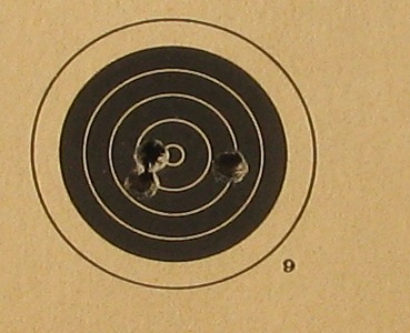

Here's three shots from bench rest with a 20MPH West Texas crosswind. I was still getting the windage correct on the left and right. The bulls-eye was the final shot.
Cricket target practice.jpg (38.3 KiB) Viewed 4007 times
