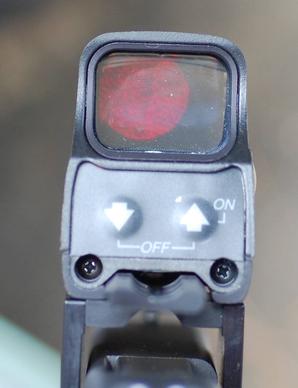

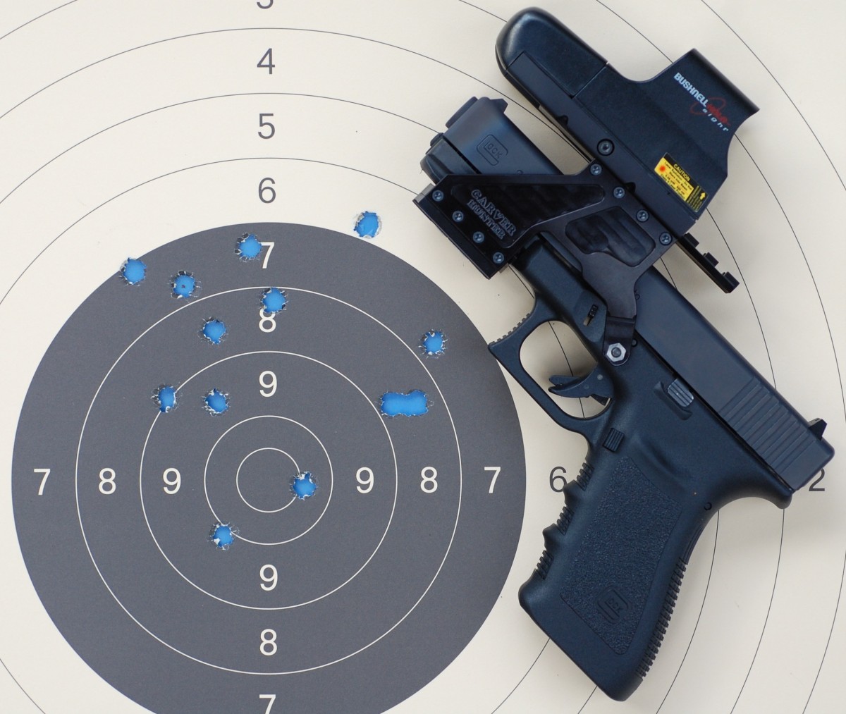

I was given a Bushnell HoloSight so I've experimented with it. Pictured is a group I shot about an hour ago. (I said I wasn't a good shot, remember.) I ran out of downward adjustment on the sight and couldn't center the group any lower. The target shows one magazine (13 rounds) fired slowly, one-handed, at 25 yards.
It was hard work to use that sight. I never saw a dot, just a close grouping of small dots, lines, and geometric shapes so close together that they could be used as an aiming point...sort of. It actually looked worse than the Ultra Dot in that respect. It had the streaking, too, but I turned it down enough to minimize that problem.
I took the pistol into the attached gun shop where they sell mostly tacticool stuff and, thus, have lots of experience with red dots like the HoloSight. I got the guy who everybody in the shop agreed had the most experience with red dots to look through it at various settings. Once it was turned down a bit from the brightest setting, he said that when he looked through it, he saw a dot. I don't. I see a bunch of little shapes close together.
It was very hard to use this sight on targets but, unlike the Ultra Dot, the red "dot" didn't disappear when I focused on the target. The pictured target is better than I normally shoot with irons but it was a whole lot more work to achieve.

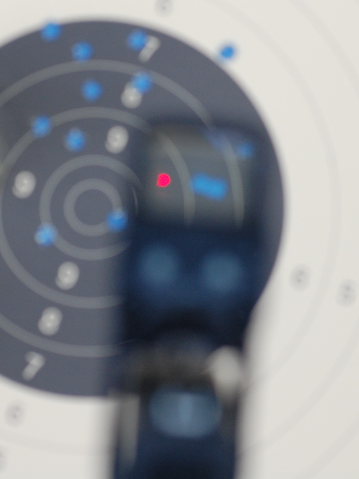

When I got home, I took a couple of pictures through the sight. Clearly, you're not supposed to focus on the rear face of the sight. Focusing at that distance, the camera records a big red blob. My eye sees a much smaller blob but one that is still pretty useless.
I set the focus of the camera lens to about 10-15 yards and took another shot. Everything in the picture is blurry but at least now the dot looks sort of like what I assume it should look like.
(My apologies for the off-center dots. It proved surprisingly difficult to hold the camera in one hand and the dot sighted pistol in the other and get good alignment.)

This seems to be what other people say they see.  I wish I did.
Not the way to look at/through the sight.
Trying a new setup
Trying a new setup
