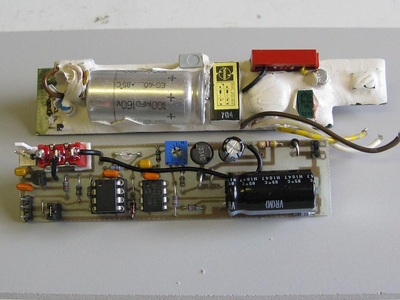

I've attached a photo of my new board below my original factory board.

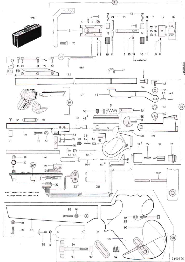

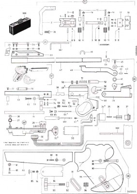

I'd like to see a picture of the board, while mounted in the pistol. In my article I note that I have not been able to examine a newer Walther. My efforts to help newer owners makes assumptions about the power switch assembly and board mount.
The board is designed so the "charged" light needs at least 90 volts to light. A weak battery may light the neon bulb but not provide full firing voltage. So if you have misfires, first replace the battery. If a new battery doesn't solve the problem then,
Misfires may be due to gunk. I suggest cleaning the pistol firing pin. Remove the grip. Remove the sight bar assembly (part 2). Both are mounted with a 4mm hex bolt.
Then rotate the breech block behind the firing pin, part 37, a quarter turn and pull it out. The firing pin and return spring, parts 36 & 35, will drop out. Wipe the firing pin clean and run a pipe cleaner through the firing pin hole in the breech to remove any powder crud.
Reverse the order for re-assembly. I've seen no recommendations for lubrication of the firing pin. However, there is a hole in the breech block end to pass air. The grip also has a hole to access this port. This suggests to me the firing pin was intended to be lubed.
If this doesn't solve the problem I'd check the charge voltage level on the large capacitor. On my early model, and my replacement board, this is about 150 volts when charged and ready to fire.
I've attached a factory parts list to which I referred, above.
