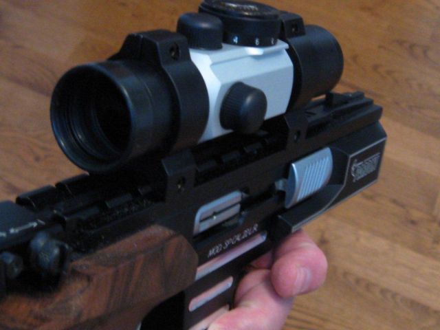

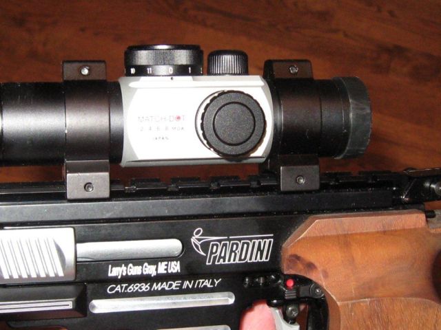

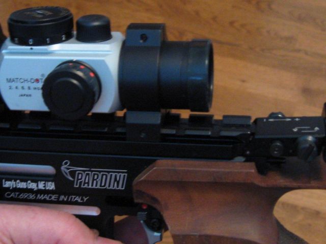

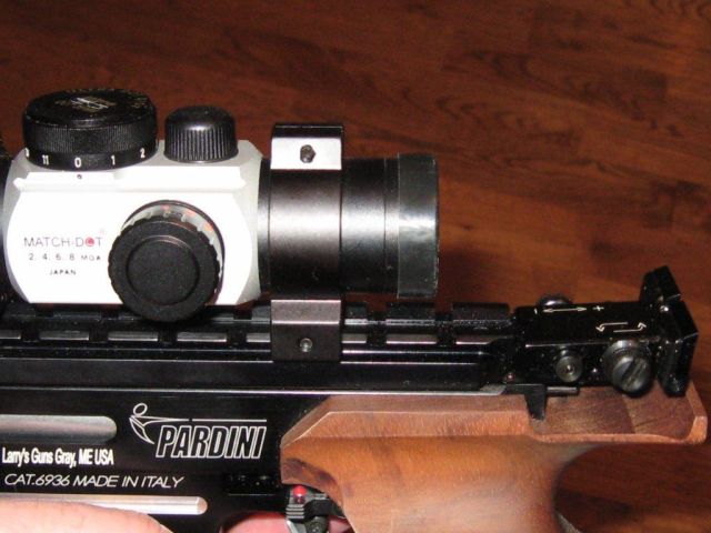

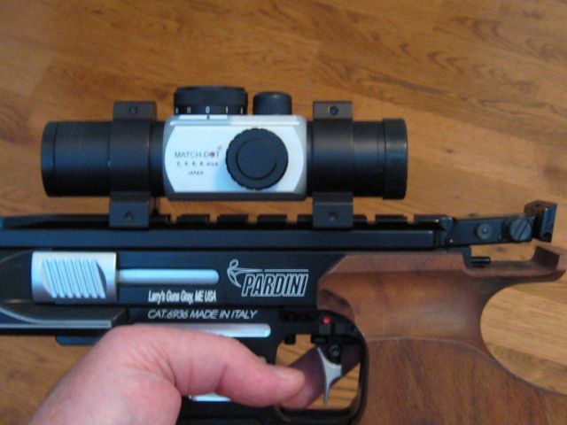

Maybe this will ease your mind. check out the pictures of the 30mm UltraDot MatchDot with UltraDot Rings on the SP-22. All OEM.
Sorry it took so long for the pics. I had to play with the Clark's 4-prong Sear spring last night, and it took longer than I figured to get it just right.
Amanda4461
Amanda4461

Thank you so very much for going to the trouble of posting the recent pics of your Pardini; truly appreciate your efforts to help. I now just looked at photos of SP pistols on the websites of Larry's Guns and Pardini USA. Trusting that both are current, neither 1 of them showed this pistol with the Weaver-type mount on it as your's has; I could see the longitudinal grooves that are factory-machined into the top of the barrel shroud, however. I am going to assume that prior to shipping your SP, Larry's installed his own aftermarket scope base onto it, which allowed you to easily attach your 30 mm Ultradot using the Ultradot-supplied rings. Thanks again.

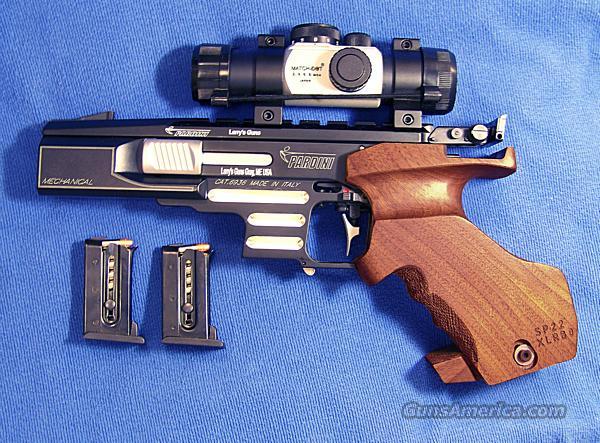

Pardini SP-22 with UltraDot pics
Alexander,
I was intrigued by your idea, so I did a small search this morning. The attached picture is of Larry's Guns' Pardini mount. It is even marked as such. While my SP-22 looks identical, it has no markings on the rail, as in the picture. I went back and looked at my invoice from 5/24/11. I bought this SP-22 during Larry's "Stimulous" program, receiving a $300 coupon on the price, and a $500 Tax Receipt for a donated High Standard Citation. The invoice lists the extra mag, firing pin, buffer, 1" Ultradot and 1" rings, but no mention of the sight rail. Guess Larry had an extra unmarked rail and let me have it. I know that it works with 30mm UltraDots, but don't know why I got a "free" mount.
Thanks for the heads-up.
Amanda4461
