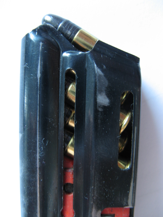

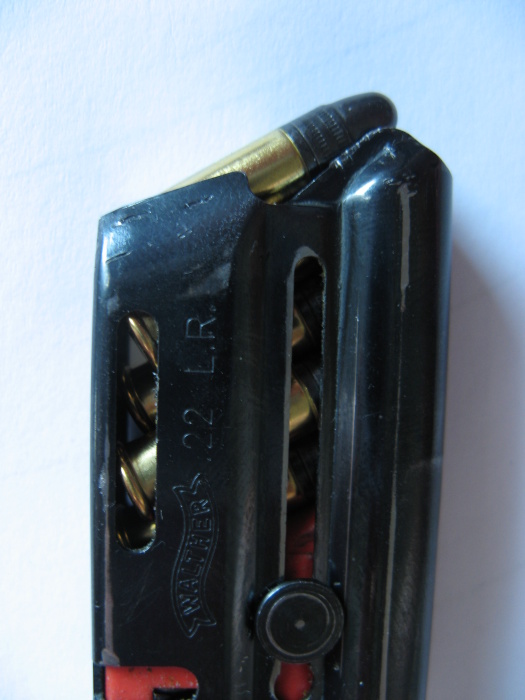

Hmm, this is strange. Just to be sure about the magazine loading, I've made photos of the correct way. Just check that the magazine looks exactly like this (front-back-front-back cartridge position with the first round bullet aiming upward).
