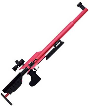

Just got our Two New one's
Just received two new Edges from AirForce, and John Promises me that they will shoot 10's, We'll see when we get them into a vice hopefully next week. If they will hold the 10 ring, we'll order more as they seem to fit our smaller athletes, if not, we'll be buying more Crosman CH 2009's.
I keep hearing that Daisy has a new Compressed Air Sporter coming out, but nothing firm yet...
Results when I can prove something one way or the other.
