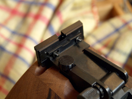

Fix it with longer (10mm used in pics) 2mm screws:

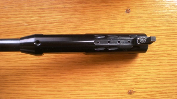

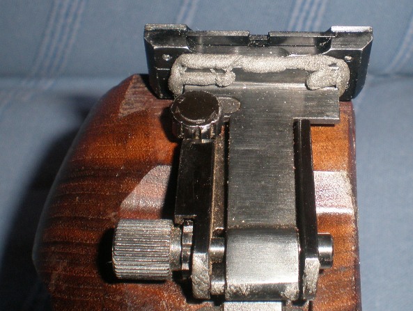

My Toz 35 M
Benelli Kite Rear Sight
Aperture: turning towards (+) increases the width of the sight: turning towards (–) decreases the width of the sight.
Elevation: turning towards (+) reduces sight aperture elevation; turning towards (–) increases sight aperture elevation
I used Steel epoxy putty stick to glue the rear sight.
On the front i use a Morini front sight.
Have raised the front sight with a piece of aluminum with 8 mm in height.
Works perfectly

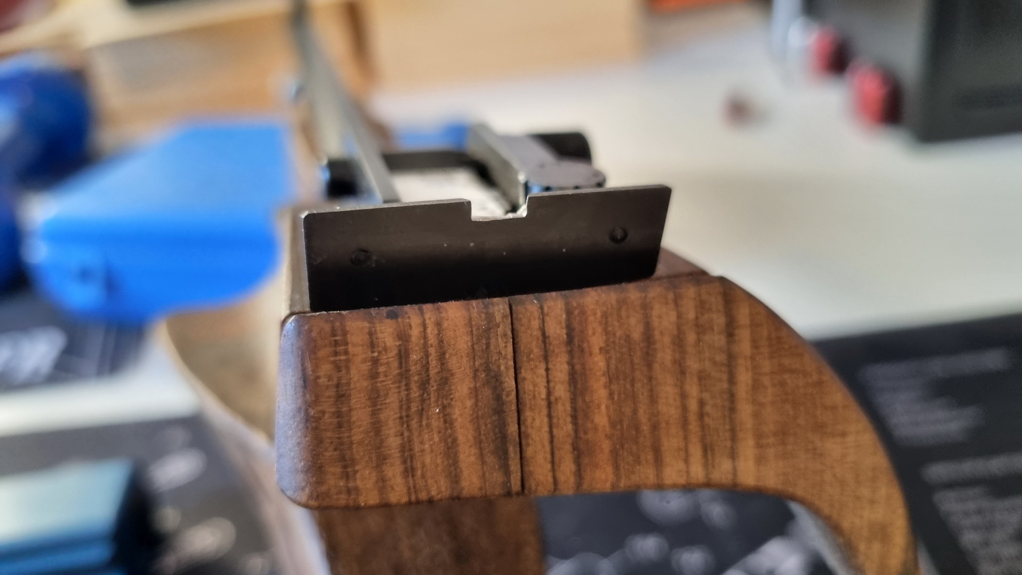

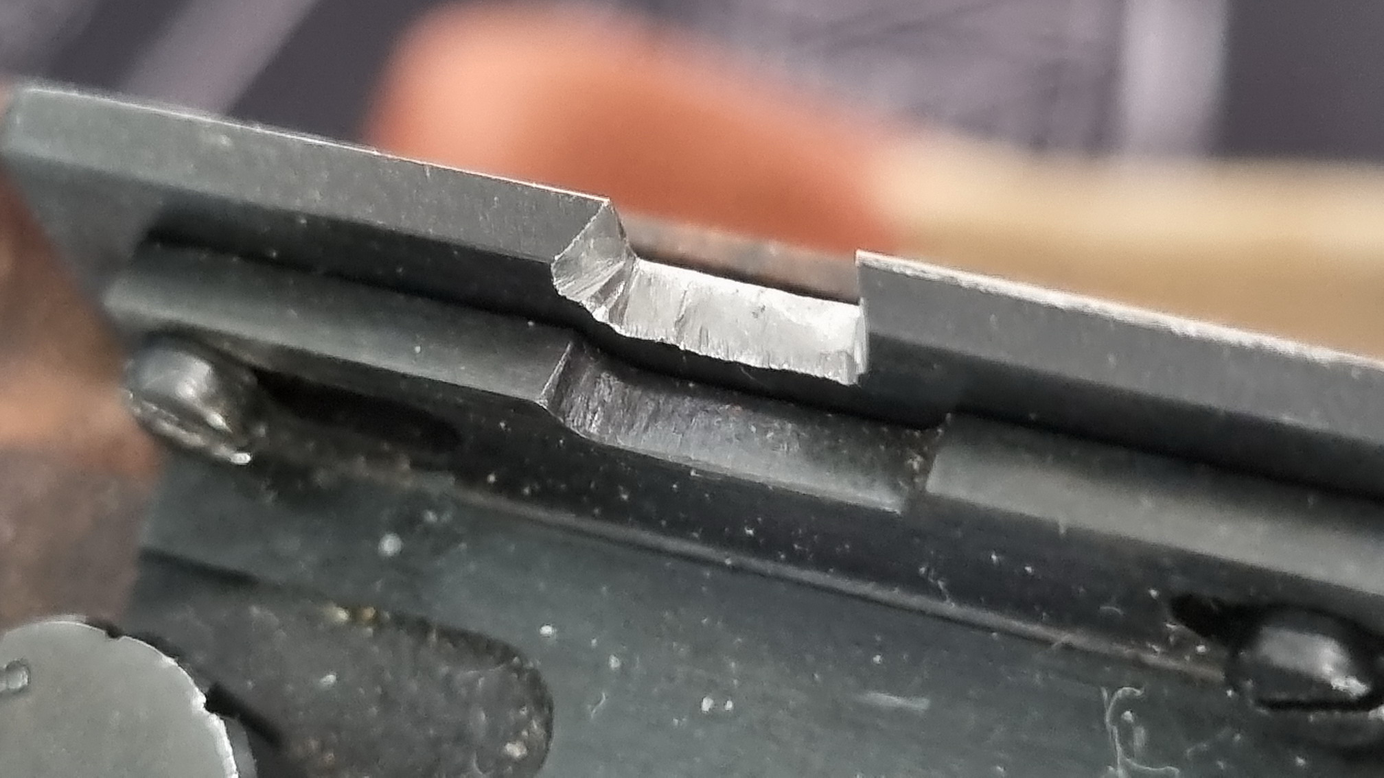

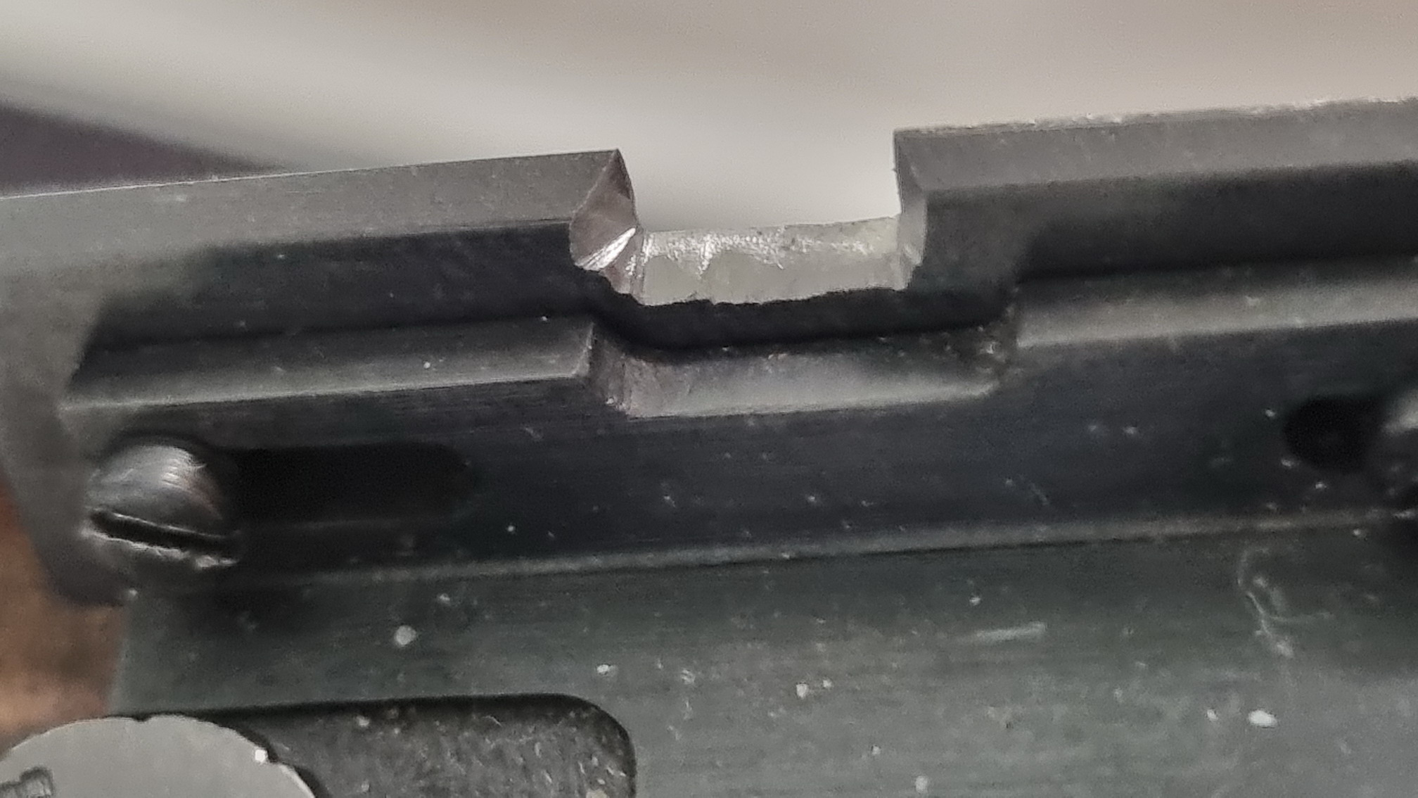

I was unhappy with the rear sight AND front sight. The front sight leaned to the left, so I used a mill file to cut down the top of the rear at downward angle to the left.
I didn't like the rear sight either, so I took a 3/16" chain saw file (very cheap) and cut the famed Russian half moon notch.
It all worked very well and was free.

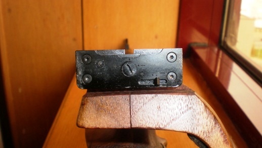

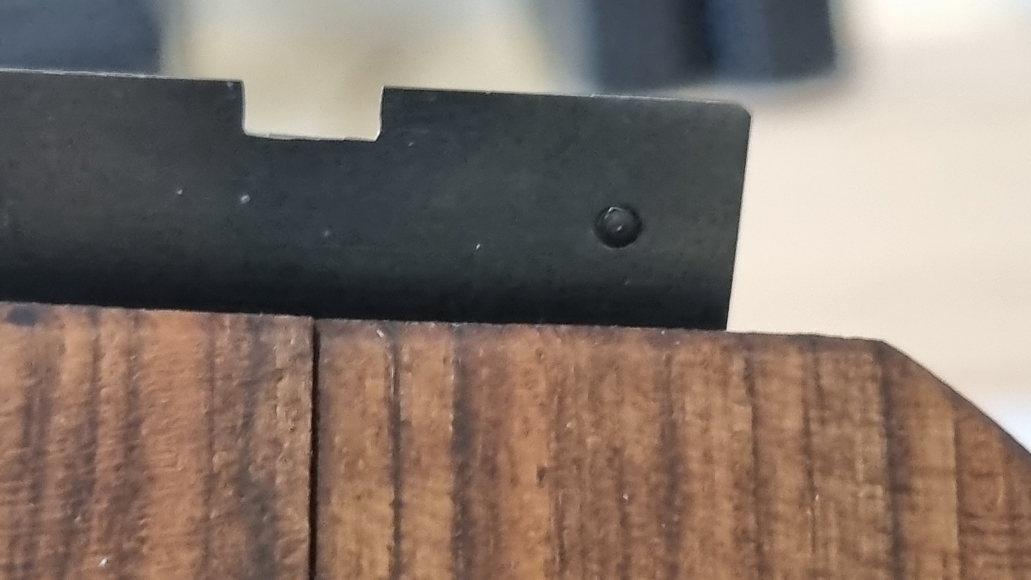

Re: Replacing rear sight on a Toz 35
i managed to borrow a pardini rear sight and mounted it on my toz, along with a wider front sight (3.9mm)
the pardini max width is 4.7mm, a tad too small for the new front sight
also it;s much taller and thicker-> the rink grip would not allow it to drop low enough. i would have had to carve out some wood for it to drop lower
so..in the end, i followed Rover's advice and got with the file on one of the replacement toz rear sights
i got it to 5mm width and now it;s perfect for the new front sight (sight picture similar to my P8X)
it also saved me ~150 euros to buy a pardini rear sight
