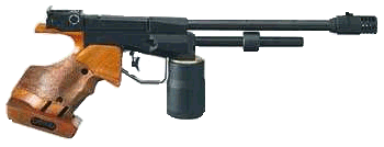

Julian, funny that you emailed just when you did as I was trying to get some information from Feinwerkbau about a C-25 [Feinwerkbau] barrel that had a compensator on it. The factory rep seemed to think this was a rifle amazingly and not two [the C-10 and C-25] of their pistol products. If I can get the price of the C-25 barrel and it will fit, that would be one part of the problem solved and as for the porting that would be done by Mag-na-port which uses a EDM machine [electrical discharge machine] and their charge is under $90, might be a tooling cost of about $30. The total cost has to be reasonable or will sell the gun and buy something else of course. What I need is schematics and breakdown instructions of the C-10 and I can't seem to find them. The work if I pay for it [shop labor] would probably force me to sell, tried to get "Brownells" to order the barrel but they passed. Do you have a place for parts and instruction manuals?
Julian
- fwbc25.gif (13.38 KiB) Viewed 3697 times

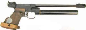

Picture of C-10 with the C-25 barrel
Julian,
I found a picture on "Goggle" search of all places of what I'm talking about. These search engines are fantastic. This looks like what I would like to try but with the added ports. The whole thing is the cost of course, if you pay shop time your dead, just as well sell the gun and buy something else. The barrel looks like it comes out pretty easily, two hex screws but really don't know. Anyone out there have shop manuals/brochures been there done this?
- C10 with comp.jpg (7.25 KiB) Viewed 3678 times
Porting a barrel
Ron:
Just to make sure I am not missing something, the photo you posted of the C-25 shows it already having a ported barrel (in addition to the muzzle break). This is not an optical illusion as I have seen other factory C-25's with ported barrels. I have also seen them without, so I presume it was added to later production C-25's.
Charles
Charles
