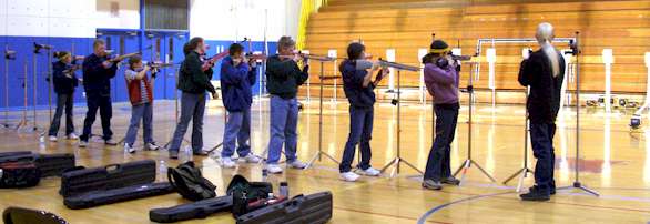

Targetworx Desires
After having worked several large matches (30 units on the line) now using the Targetworx system here are some comments and desires:
(I've shot on them in the Sectionals as well)
I do understand that some of these add cost, but they would be timesavers
1) Easier loading ... with the curled rolls it can be frustrating to try and get them past the bottom lip ... I carry a pair of sissors w/ me to trim the end
2) Goes w/ #1 ... maybe a sharper lip at the bottom to tear/cut the target rolls off neater .... makes loading easier the next time
3) I've had some of the target roller wheels strip out ... a dot of JB-Weld on the threads of the shaft fix this ... still a bummer during a match to have to stop shooting to retrieve a wheel that's come loose (only happend twice during a match)
4) A small halogen lamp assembly on a flex gooseneck as an option to place above the target box. The worse mess is always the lighting of the targets. If our current lamps are on the floor there is a wide shadow (1/4" or so) across the bottom of the target .... Ceiling mounted lamps cast the shadow across the top ... Attached lamps would be a very small bit of hassle when moving the targets and provide more uniform lighting.
5) As an option ... a small spool to roll up the cord ... when you have kids and 15m cables .... you get tangles.
All in all the NM shooters really like the Targetworx traps. When I borrow a few to bring to our range, it's a treat for the kids to shoot on these.
