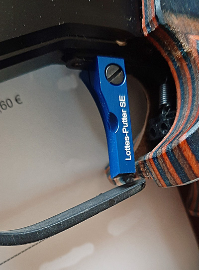

Hello
A little off topic.
The putter is very grippy. The orange or blue Lottes trigger blade for Morini CM200 is 30mm long. Depending on the grip design or finger length, the triggerblade can perhaps also be used on the Morini 162.
