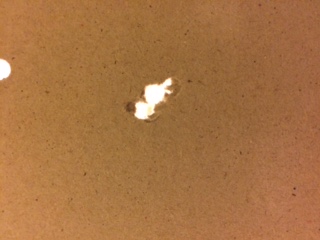

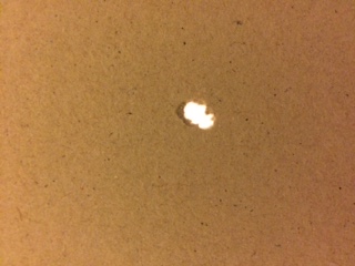

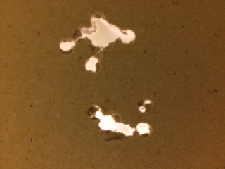

In my opinion it doesn't matter what pellet you use, what matters is to balance the gun to the pellet. the attached were shot at 20 yards with the gun in a clamp, 10 shot groups.
they are R10 4.50 pistol, pistol was a FWB P44. if I shot in competition with the gun not adjusted to the pellets, my score over 60 shots would be noticeably less.
Power screw set to low:
as screw turned up:
Optimum power for this pellet:
as screw turned up:
- 10 shot 20 yrd best setting.JPG (28.9 KiB) Viewed 3176 times
- 10 shot 20 yrd 1 adjust.JPG (27.8 KiB) Viewed 3176 times
- 10 shot 20 yrd.JPG (24.14 KiB) Viewed 3176 times
