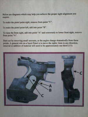

Re: Feinwerkbau P8X review: how to improve it?
Could someone explain to me why part A in which material is added raises the front sight?
- Posts: 747
- Location: Minneapolis
Your second finger supports a lot of the weight of the gun. By building up that area the front of the gun naturally points a little higher.mhayford45 wrote: ↑Fri Nov 19, 2021 2:37 pm Could someone explain to me why part A in which material is added raises the front sight?
