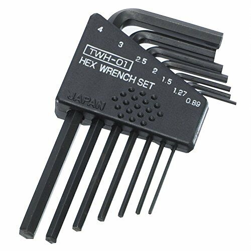

After talking with Pilkington, I'm going to try adjusting the micro switch to eliminate it as the source of the problem. This appears to require a 1mm hex wrench. Is that the correct size? Would like to be sure before I go on a mission to find one.
BTW, does anyone know where they're readily available in stores? Smallest I have now is 1.5 mm.

Re: Dead Morini Air Pistol Electronics?
eBay
7 piece metric ALLEN KEY set small mini sized 0.89mm 1.27mm 1.5mm 2.0mm 2.5 F/S
Posts: 3584
The eBay set is a bit bogus. 1.27 mm is 50 thousandths of an inch, and isn't metric at all. 0.89mm is 35 thousandths of an inch.
Actually, 1 mm isn't a standard metric size. The closest true metric options are 0.9 mm and 1.3 mm. Unless you are near a large city with a metric specialty supply house, you will probably have to order one. A shop that sells to the electronics trade might also carry them, at least in a set.
McMaster Carr sells them, as do many industrial suppliers. The catch will be making a minimum order. McMaster sells all sorts of useful stuff, and I usually don't have trouble finding something I can use. They tend to have good prices on batteries, for example.
If you are going to own European pistols, having a high quality metric hex key set is a good idea. McMaster has those that go down to 0.9mm or even 0.7mm
The .089 works, thats what I use.
Posts: 3584
That close enough to 0.9mm that it won't make much difference as long as the screw isn't stuck. If that is the case, you MIGHT be able to find a 0.035 inch ("0.89 mm") hex key at a good hardware store.

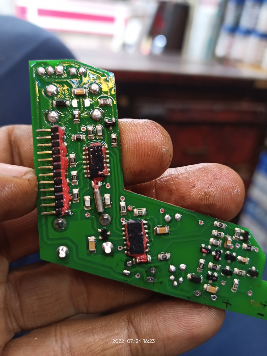

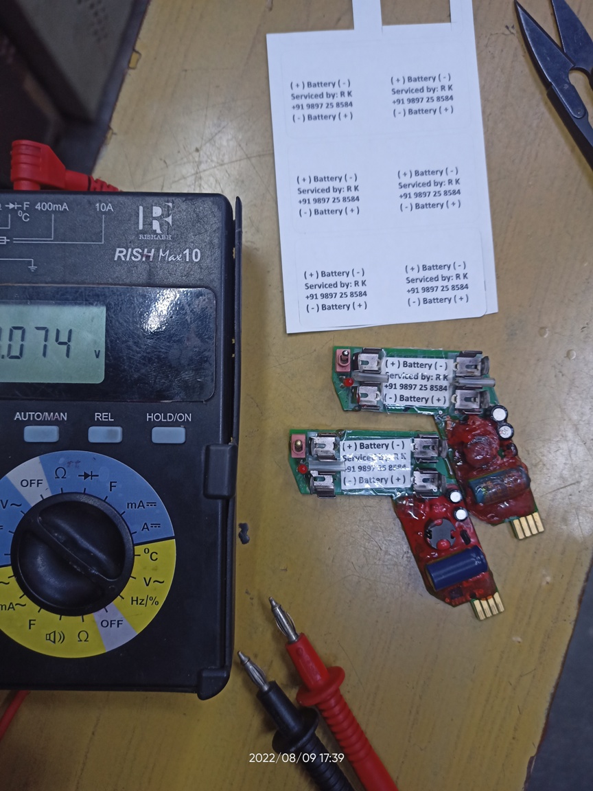

rk.newdelhi.india
Joined: Mon Sep 26, 2022 1:51 am
Post by rk.newdelhi.india »
Hello friend/friends,
Greetings.
It's my great pleasure to introduce myself as a new member here.
My name is R K Singh and hold a handful experience in all type of electronic pcb repairing and in research and development as well.
We at "Rama E. Engg." are capable to restore Morini trigger circuits with 100% positive results. Till date we have delivered more than 600 Nos. repaired circuits worldwide.
Locking forward for reply. Thanking in anticipation.\
R. K. Singh
Rama E. Engg.
Near Head Post - Office,
Baraut, PIN - 250611
District - Baghpat,
UP INDIA
Mobile No. +91 9897 25 8584
E-Mail rk.newdelhi.india@gmail.com
Before Repair
Before Repair
After repair
After repair
