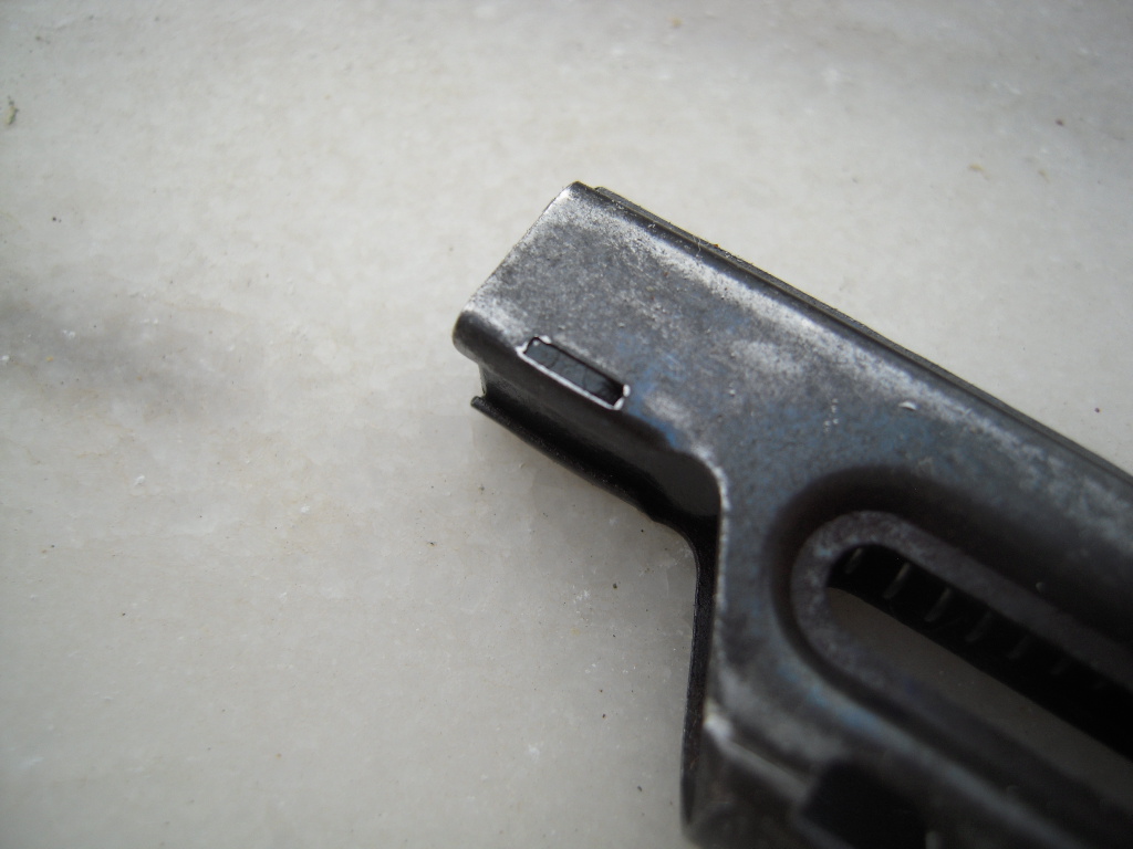

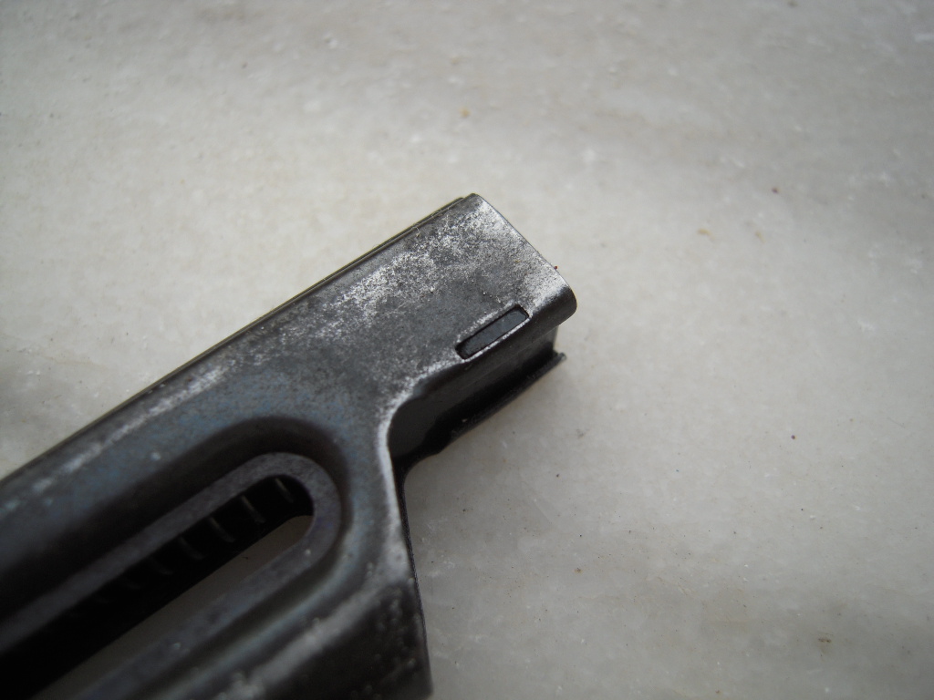

I wish to take apart the FAS SP 602 magazine, for cleaning and changing the follower or the spring, but I am not sure how to proceed.
Any pointers?
There is a rectangular cross-slot bar located near the base of the magazine, that seems stuck or rusty.
How is it dislodged?
Pushed through?
Thank you for your help.

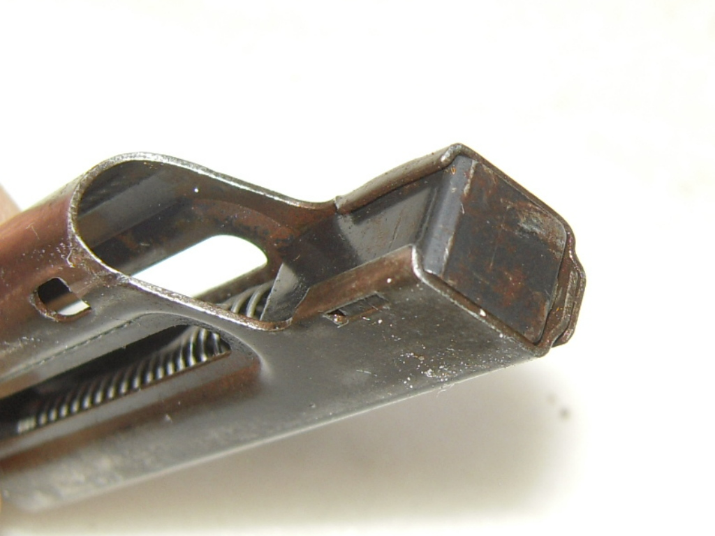

That looks like a newer magazine which the base is not made to remove. To do so would mis-shape the magazine. The older magazines with the metal follower had a removable base plate.

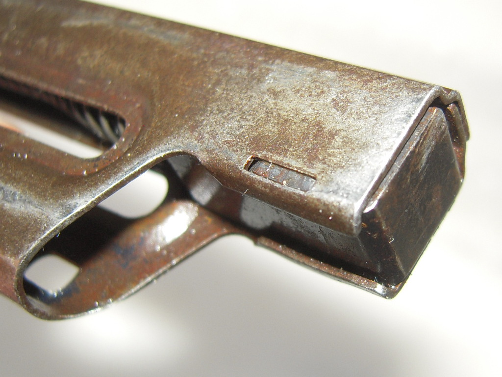

This is a 602 magazine with the removable base plate.

There is no visible base to be removed, indeed.

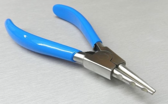

A Bow Opening Plier or Reverse Action Plier may do the job of disassembling the FAS magazines, I'm told.
I wonder if anyone has tried it.
