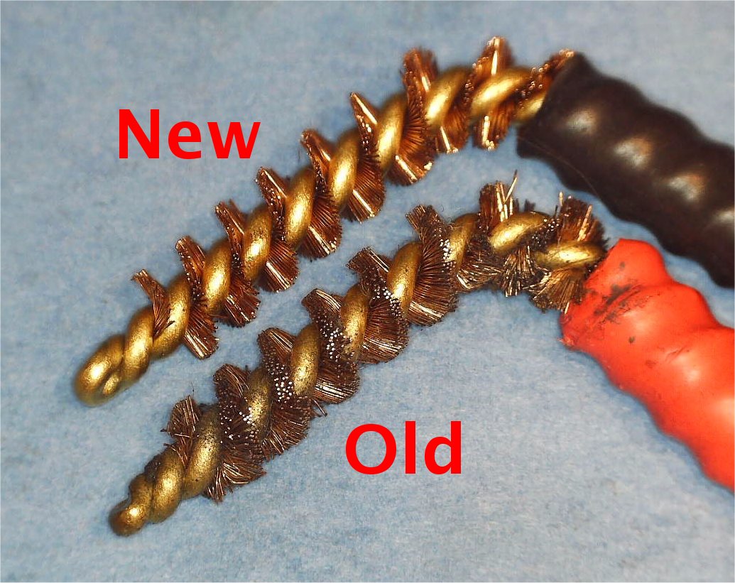

Lately, I've noticed that they seem to be wearing out much faster than before. The team seems to go though them in less than a year. I took a look at the latest bag of brushes from Brownells, and compared it to one of my personal brushes that I've probably had for close to a decade. They've changed the design, and they have WAY fewer bristles in the spiral than they used to:
I submitted a highly unfavorable review at Brownells, and I am now on the lookout for a good replacement. It's hard to tell from on-line images, but a lot of the options don't look much better. I'm going to purchase a variety of brushes, and will report back once I've identified a good replacement.

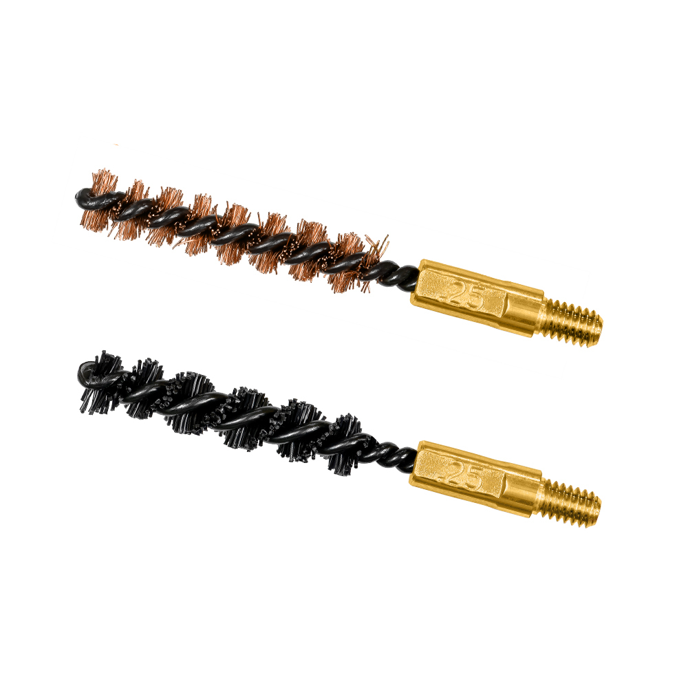

Take a look at the Otis line…their bore brushes last a long time and we use them hard.
https://otistec.com/6mm-243cal-bore-bru ... -1-bronze/
Posts: 3255
Re: .22 Chamber Brush Problem
Thanks! They look pretty bristly, but they only come in shorter "pistol" length. That will make them a bit harder to bend for a good handle, but I can give them a try. The longer "rifle" ones give you a good long handle to reach into Pardini SP's ejection port without dismantling anything.

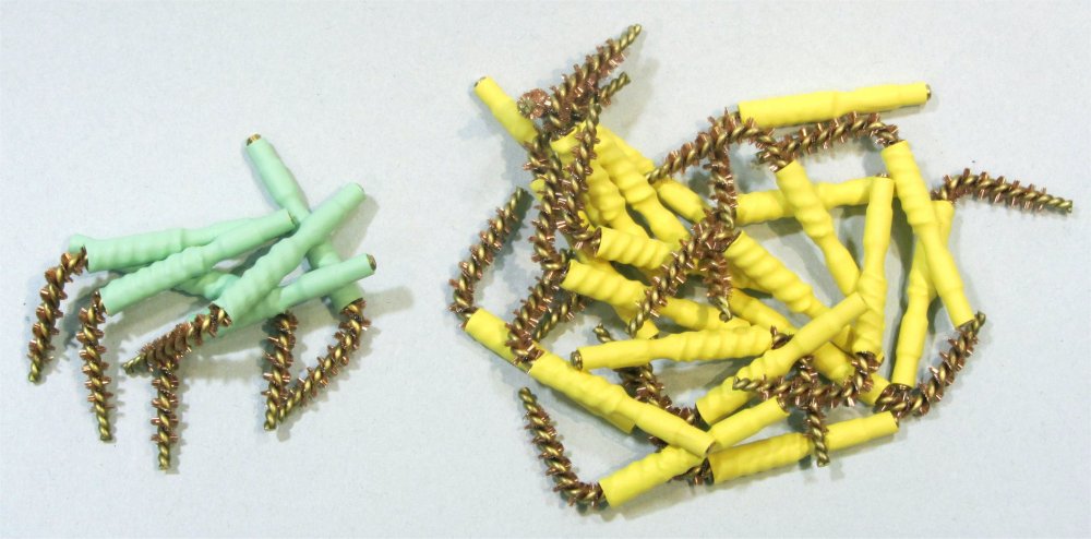

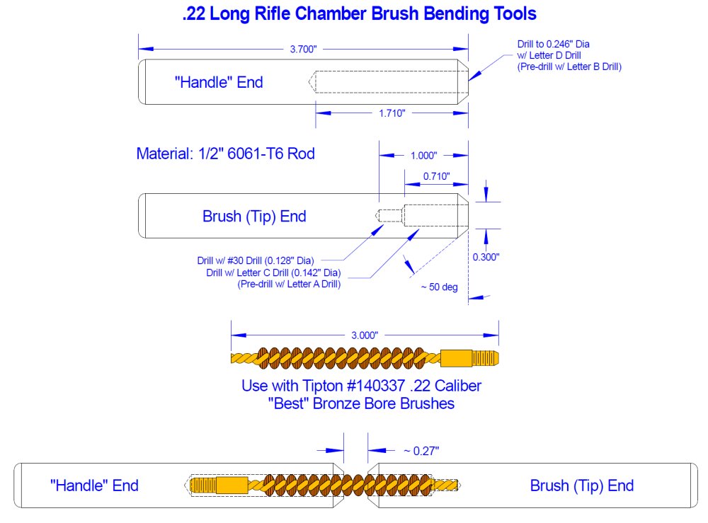

I spent some time over the Holidays making up a large batch of chamber brushes. It turns out MidwayUSA has a fairly good price on the Tipton .22 caliber bronze brushes ($6.99 for a 3-pack). They run free shipping promotions fairly often, and I bought 10 packs several weeks ago.
When I first started making these, I designed & machined a pair of bending tools for the .25 caliber Brownells brushes I used to use. I made a new set redesigned to work with the Tipton brushes:
For an individual who isn't making tons of these, I suspect a couple pieces of 1/4" ID pipe would work fine.
I've found it useful to have two styles. One version is bent at 90 degrees for cleaning barrels when a pistol is disassembled, or for Benelli MP90/95's on the firing line. The other is bent at about 75 degrees, which allows cleaning the chamber of Pardini SP's on the firing line.
-TT-
Posts: 397
Post by -TT- »
Color coded, even! :)
Posts: 3255
I used to code them by date using different colors, but that turned out to be a waste of time. Some get used a lot, and some hardly ever, so age has nothing to do with what condition they are in.
