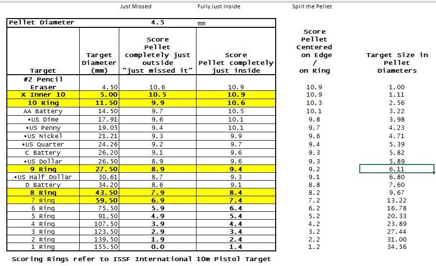

Re: AP: Decimal Scoring - QUIZ TIME !!!
Answers for Common US Coins
PDF file here with link to source Excel File and VBA Function Program
http://www.targettalk.org/viewtopic.php?f=2&t=56346
and with any luck, an image here for you to see.
I did this so that I could answer the question for the young shooters I coach.
- CoinScores.png (34.88 KiB) Viewed 1471 times
