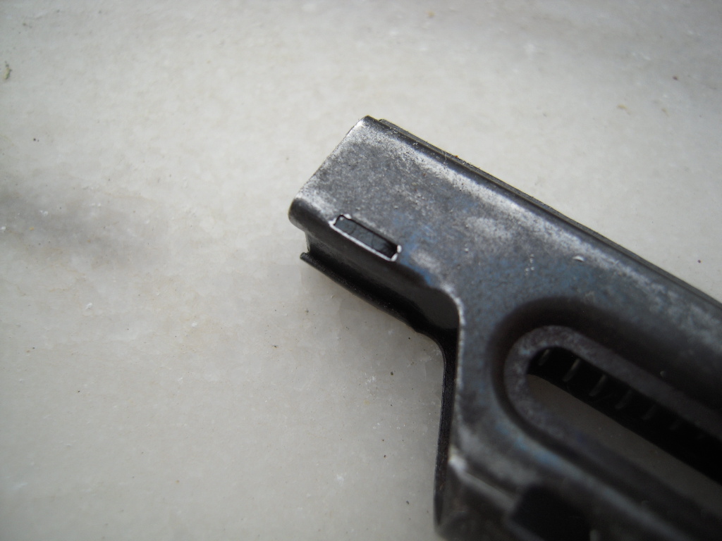

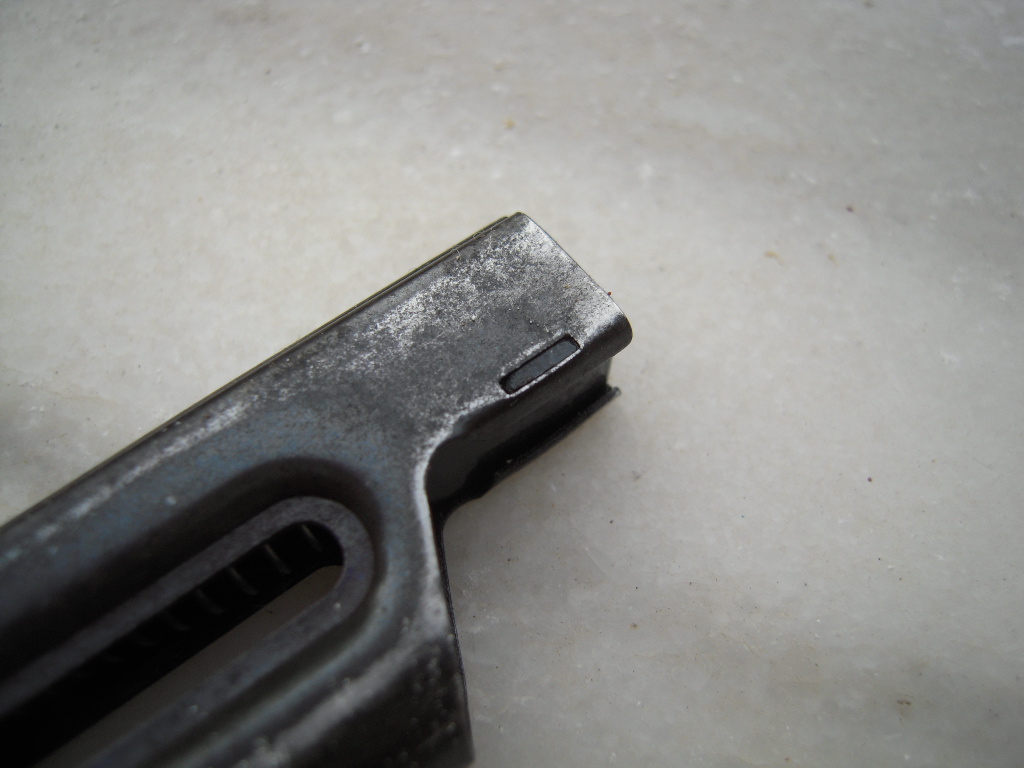

I wish to take apart the FAS SP 602 magazine, for cleaning and changing the follower or the spring, but I am not sure how to proceed.
Any pointers?
There is a rectangular cross-slot bar located near the base of the magazine, that seems stuck or rusty.
How is it dislodged?
Pushed through?
