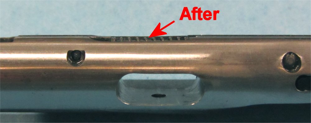

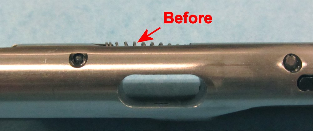

I took the pistol apart and scrutinized it with an intense scrute. The tip from Lucas90 to check the firing pin revealed that the firing pin spring had gotten kinked, or the shoulder on pin that it pushes against is worn. In any event, the spring was bowed upward where it would rub on the inside of the bolt channel.
Firing Pin Spring Before.jpg (54.23 KiB) Viewed 34993 times
I took a pair of fine needle nose pliers, and rotated the spring so it no longer protruded above the top of the bolt:
Firing Pin Spring After.jpg (51.52 KiB) Viewed 34993 times
I cleaned everything, applied a light film of thin oil on the bolt & a few other wear points (like the top of the cocking "ears"), and reassembled it.
When the student arrived for practice, I gave her 100 rounds of a specific lot of CCI in case there were any problems. She fired 65 rounds without a hiccup!
We have a match this weekend, and I think we will leave it alone for now. I have a replacement firing pin & spring on the way, but they won't arrive in time to install and test before the match.
Thanks to everyone for the ideas & suggestions.

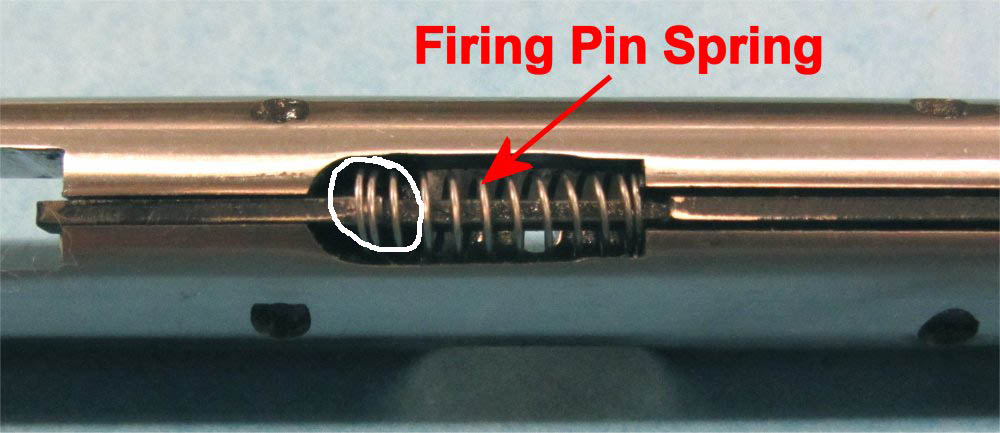

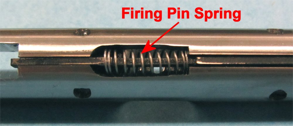

In the top picture, it looks like the spring is not pushing against the shoulder of the firing pin. Is the spring smaller on one end? Is it in the correct way?
Posts: 3255
Re: Walther GSP Trouble Shooting?
Good eye! I think that is exactly where the problem is, but I'm not sure what "normal" is supposed to look like. I didn't have time to tear apart our other GSP to check. From what I could see, the top of the shoulder on the firing pin has worn down to the point where the end of the spring can slip up over it. A smaller spring, or an asymmetrical spring with one small end would prevent that from happening.
The exploded diagram I have is a drawing, and doesn't really show much detail. The spring looks symmetrical. For now, it looks like it will get through the match this weekend, and by Monday I will have the new parts and can fix it properly.
I'm still a little concerned that this isn't the whole story. The added drag it gave the slide wasn't really noticeable by feel, but A) it's clearly not right, and B) the added drag is consistent with the types of malfunctions we saw. The other change I made was to go easy on the oil, which should help as well.
Never having changed a firing pin on one of these, is there anything I should know? The pins appear asymmetrical, and I assume it's obvious which side they come out & go in from. I've got a nylon bench block with a V-groove, but the round shape of the bolt and the offset location of the pins means it's going to try to roll when I use a punch on the pins. I'm guessing they aren't supper tight.
-TT-
Posts: 397
Post by -TT- »
Simply rotating the spring is a good test, but it isn't going to stay that way. It definitely isn't sitting right at the "left", that's the trouble.
In addition to corkscrewing, it's going to have less tension since it is riding a mm or two too deeply. And, I bet it's binding up inside the spring channel as well as touching the bolt channel.
If flipping the spring doesn't correct it, try torquing the end coil to see if you can reduce the diameter of that final twist.

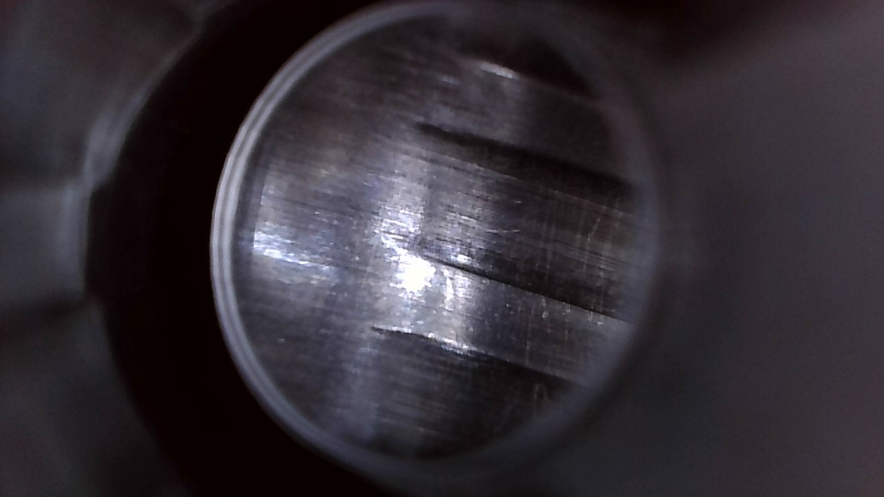

chance has it i just aquired a teslong borescope (long flexible version NTG100 from aliexpress - $55 shipping included)
here is a video of the GSP 22 bore: https://youtu.be/v8_WJCy5tZk
and a picture of the start of the rifling:
i don;t see any carbon ring...
