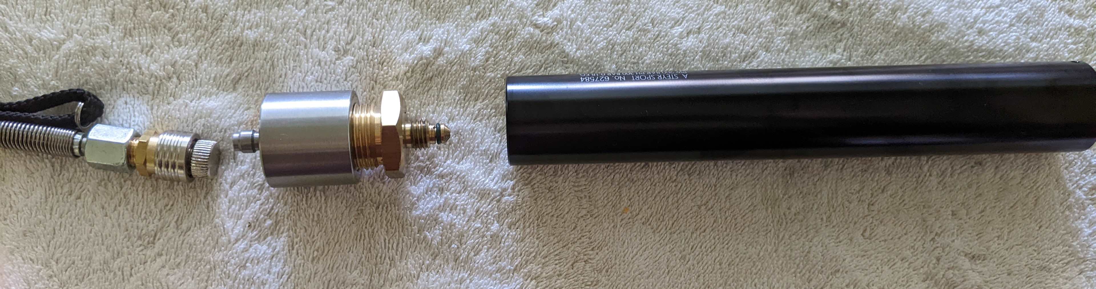

Does anyone have/use one of the Best Fittings Steyr LP fill adapters? The description states that they are now “drilled through “ to allow for conventional bleeding of the charging system without the need to partly unscrew the reservoir whilst still under pressure.
https://www.bestfittings.co.uk/shop/fil ... l-adaptor/
I always get a little nervous while doing this, seems like a better idea.

Yes. We use the BEST fittings adapters for both Steyr and Walther air guns. They work fine.
This is the Steyr adapter that allows you to unscrew with cylinder without pressure on the threads-

m1963 wrote: Mon Jan 20, 2025 12:59 pm Yes. We use the BEST fittings adapters for both Steyr and Walther air guns. They work fine.
Just to be clear, you can bleed the line pressure first and then unscrew the cylinder under no pressure?
Is your setup similar to mine? I have the Steyr supplied fill probe.
Posts: 646
Re: Filling Steyr AP Cylinders ?
The cylinder unscrews, unpressurized, due to the design of the adapter. Less loss of air.

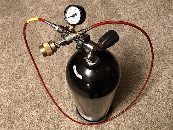

All this is rather over complicated when you can screw the Steyr Adaptor directly into the DIN thread of the SCUBA tank.
It's worked for me for the last 30ish years!

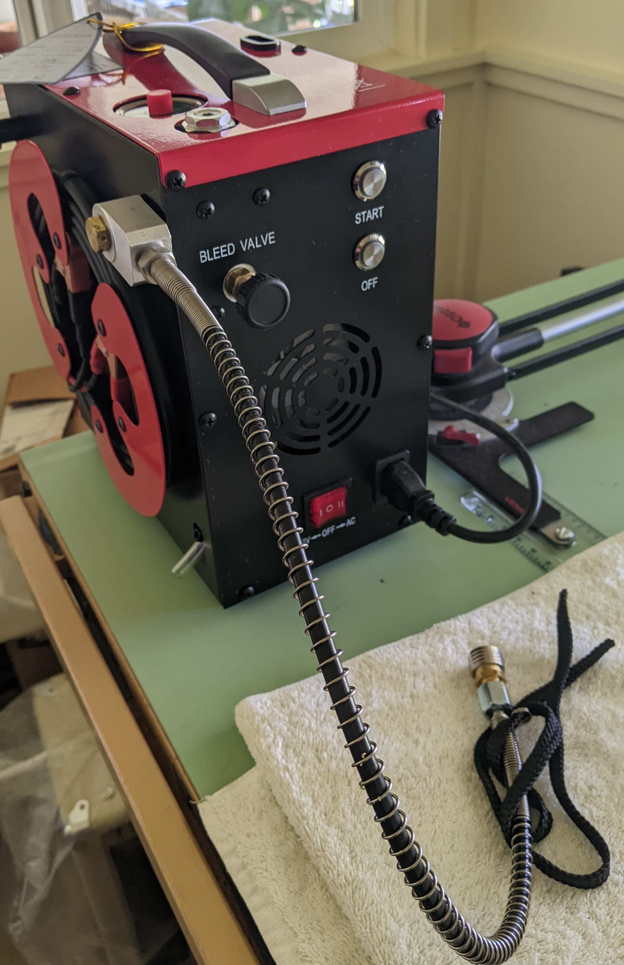

Not everyone fills from a bottle or tank. I use one of the cheap Chinese compressors straight to the air cylinder. No trip to the dive shop!

If you can bleed the hose of that compressor there's no reason why you shouldn't use one of the BF adaptors with a foster connection, like so:

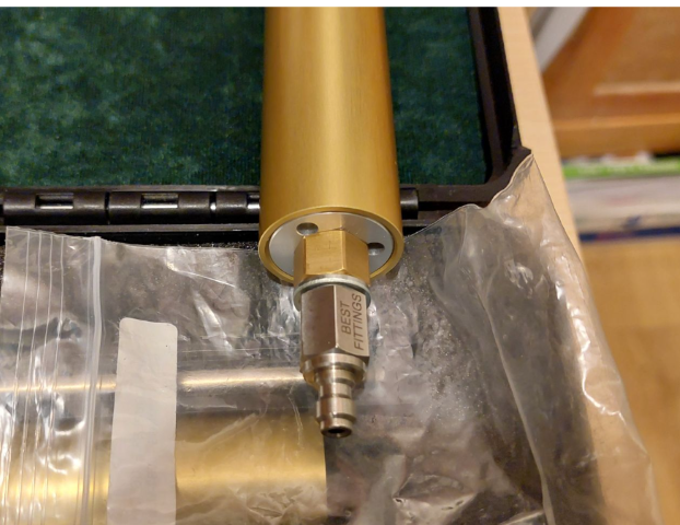

What is the name of the part that connects to the Styer fill? Does Best Fittiings carry it?
Thanks.
Posts: 646
Are you asking about the QD (quick detach) quick coupler....
https://www.bestfittings.co.uk/shop/qui ... pler-plug/
or the DIN female adapter?
https://www.bestfittings.co.uk/shop/fil ... -bsp-male/

Both. Thanks I ordered the two parts.

My compressor shown above takes 80-90 seconds to fill my Steyr LP50 standard cylinder from 70 to 200 bar. Not familiar with your AV compressor but something seems amiss 🤔.

The best fitting adapter works very well as you loose much less air as you manically unscrew it as fast as possible and the threads are no longer under high pressure as you screw the cylinder off.
