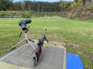

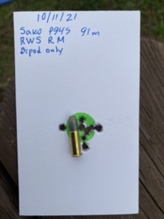

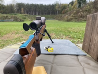

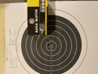

I don’t compete. I shoot prone position at 100 yards and beyond. But this doesn’t mean I don’t compete with my best results and constantly chasing improvement. Yes I shoot 22 lr, Anschutz 1907 diopter sights and Sako p94s range scoped.
