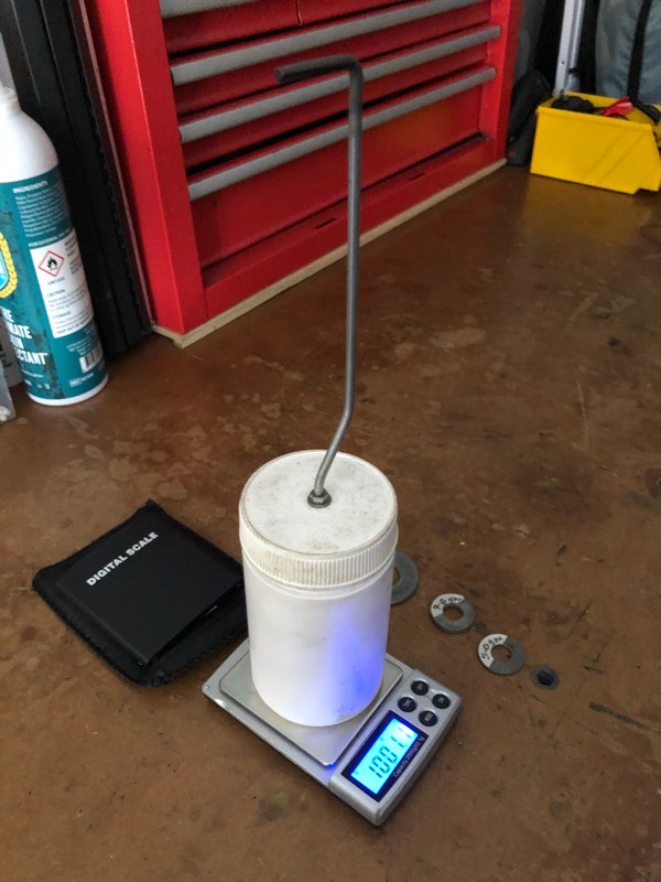

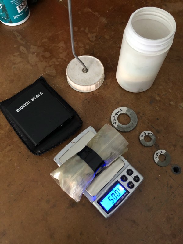

I find the Lyman gauge tricky to use but cobbled together a weight set for my ISSF shooting. I have a plastic pot which, plus lid and hanger, has enough lead bullets and pellets in it to give me 500gm. I also have a further plastic bag of bullets/pellets weighing 500gm which fits inside the pot with the other weights to give 1000gm. I also have some weighed washers to slip over the shaft to give me a margin. I filed the underside of the cross-member of the shaft to a knife edge to sit better in the trigger blade notches. Works well.

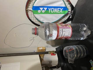

Nah, here is my wabi-sabi version of completely adjustable weight (currently set to 1025g)
