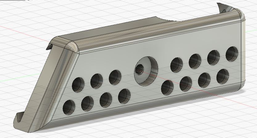

I designed barrel some weights for my Walther LP400. I can press fit pellets in several holes to add weight and adjust CG.
Not sure if its useful, effective, worth my time or even legal.
Appreciate comments

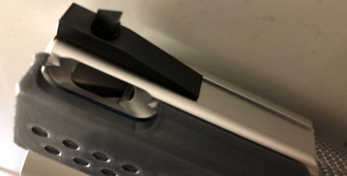

Here's some bits I designed and printed a while ago for a bargain basement Lov 21 pistol. A palm shelf and extended sight/weight box.

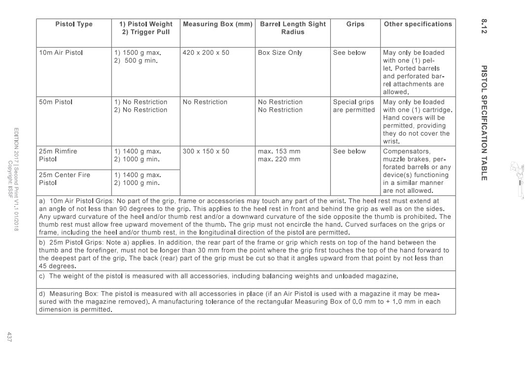

I'm resurrecting this topic, as i'm also in 3d printing and really don't get the crazy prices for barrel weights. Like, $30 for a 15g weight? What if i just make a diy 15g weight (i have a precision scale to check) and install that instead? Is it "illegal" to do so? I mean, they check the weight of the entire pistol to see if it's within limits, right? Or, i'm missing something?..
Posts: 1231
Re: 3D Printed Barrel Weights
elias k,
As long as the pistol fits the box and is below the max weight, you are ok.
