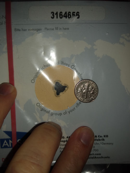

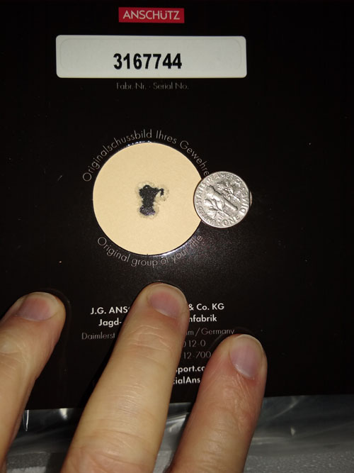

The factory offered these 10 shot groups at 50m from 5430 Factory barrel (not custom Shilen)
Can't control the world, just my aim, well most of the time.....
Posts: 2105
Re: 3p new barrel - which one? Shilen, Lilja??
For those of us not in the US, how big is the coin? EDIT so a dime is 17.91mm dia. Those groups are nice, but not 7-9mm edge to edge (the smudges at the actual edge not the hole).
Those factory groups were shot with the barrel (no stock) clamped into a vice, and so are not directly comparable to Lapua/Eley test groups where the receiver is held in a fixture and the barrel free floats. The group in the handbook is also cherry picked to the best of my knowledge.
If Anschutz North America's Custom Shop will guarantee ten shot test groups under 9mm edge-to-edge, get it in writing and buy a lottery ticket straight away.

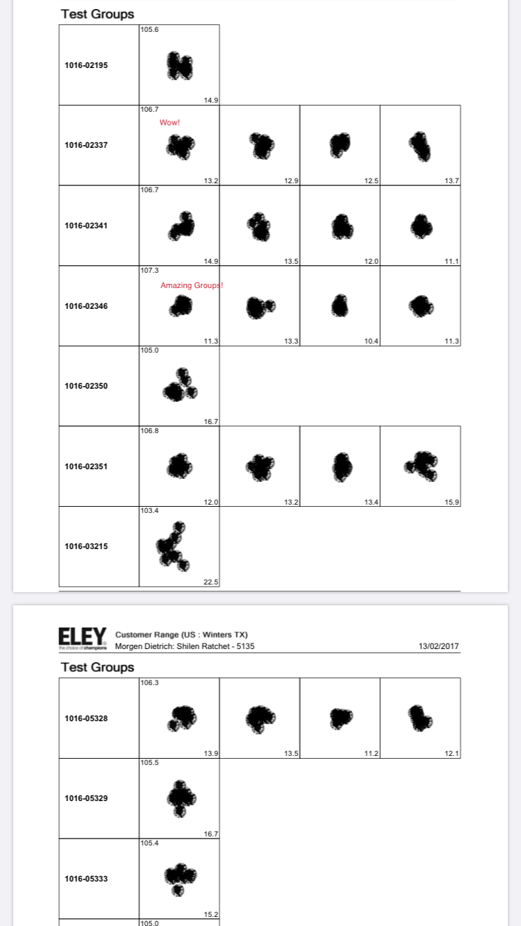

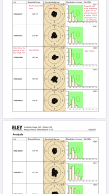

Eley posted a new range record for a projected 60 shot score of 643.6 yet the edge to edge diameter of that group was 15.6mm over 60 shots. I don't have the 10 shot group best size, you would have to ask Morgan Dietrich.
Here is the link https://www.facebook.com/ELEYUSA/photos ... =1&theater
A Shilen Ratchet barrel. 2/13/2017
From the Lapua side their range record, as shown to me by the person who holds it, was 9.96mm @50M and 17mm @100 from the same batch but 10 shot groups.
Again, a Shilen Ratchet barrel. 8/22/19
So a Shilen Ratchet barrel has set test range records at different places with different ammunition.
7-9mm might be overly optimistic. My best lot of Eley tested to a score of 632.9 with a 60 shot diameter of 18.5. It just barely beat out my Lapua control lot by .5 points over 60 shots. If you can find 12mm-13mm consistency in a test lot, and you do your part I believe you would have the capability to win anything.

See the photos for my testing several years ago. 40 shot agg is what a shooter wants, no fliers. A single 10 shot group can be great but if the next one can’t repeat it then you are in a tough spot.
10xII action, 1” shilen ratchet barrel, 21” long. uptagraft tuner bloop tube. Bix&Andy trigger
