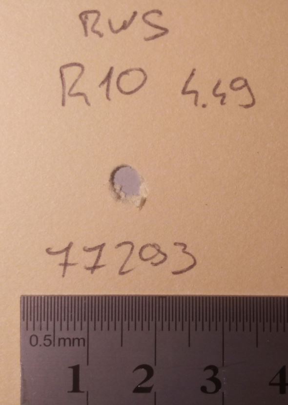

First to establish a base line, I shot the RWS R10 Pistol, 7gr 4.49
RWS R10.JPG (48.03 KiB) Viewed 13130 times
Needless to say these gave me the smallest result of the four I´ve tested, although they cost about 10-11€ a tin around here!
The group is pretty similar to the H&N Finale Match Pistol 7.56gr 4.49 I´ve tested two years ago.

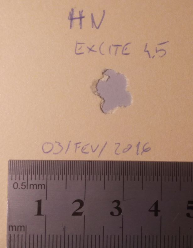

Second came the H&N Excite. These are entry level pellets, in 4.5 and didn't specify the weight (my guess is around 8gr)
HN Excite.JPG (47.28 KiB) Viewed 13130 times
I was not excited about these ones ;)
I had pretty good experiences with top level H&N pellets in the past, so I had high hopes for these...
At least it gave me an excuse for all the shots I couldn't call properly (yeah, right, it's the pellets fault!)

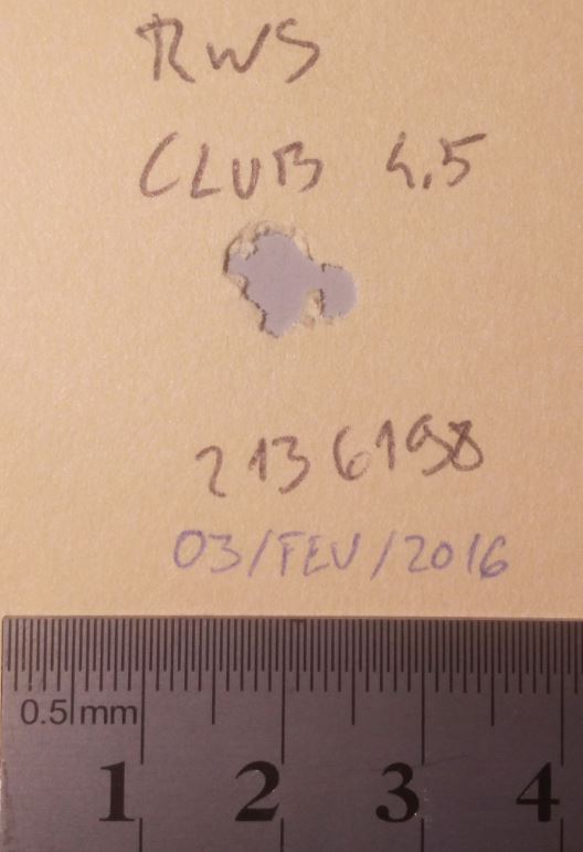

Third in line was the RWS Club (orange tin)
RWS Club.JPG (45.36 KiB) Viewed 13130 times
Better than the H&N Excite, but nothing to be proud of...

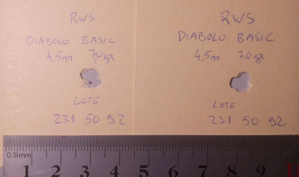

Finally came the RWS Diabolo Basic (green tin), in 4.5 and 7gr
I've tested these a few times, just to be sure. I was getting afraid my gun had developed a taste for the finer pellets in live...
Huge relieve!
I know the group size is larger than the R10, but they cost about 1/3 so I can´t complain!

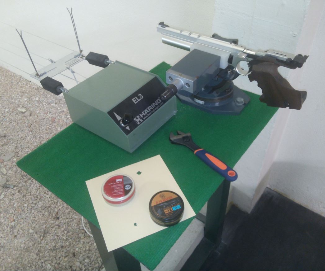

rmca wrote:clamped in a vice
That's only about half the story.
Posts: 1231
Re: Pellet Testing... AGAIN!
We have a vice with horizontal and vertical adjustments bolted to a metal table (shooting bench), that is then bolted to the floor.
Not the strongest of supports, but with some care, it can yield some pretty decent tests.
The vice has some different inserts for the jaws, the ones we use for pistol have a V in them. These are made of some sort of smooth but hard plastic.
The pistol is them clamped by the cylinder and some of the regulator, with care!
This gives a better hold than the recommended trigger guard spot.
I will post a picture next time I have it setup.
Need more info? ;)

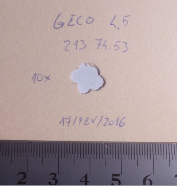

Wynne G Oldman,
I tested some Geco pellets today.
Same setup, same pistol, same number of shots (10)
Good enough. But the RWS basics still performed better (cue Rover...) ;)

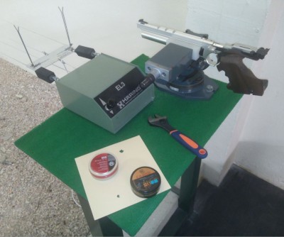

JamesH
Here's a picture of the test setup.
BTW I clamp my LP1 by the trigger guard, as recommended by Steyr. I was always afraid of crushing the cylinder.
Posts: 1231
I put the pistol in the vice finger tight, and then only about 1/6 of a turn with the wrench.
The vice jaws have a V in the middle, so I have four contact lines with the cylinder, which spreads the pressure.
I also try to get a bit of the pressure regulator on the vice jaws.
I have tried clamping it by the trigger guard, but it need to be clamped harder than I wished. Didn't like that feeling one bit...
Also, the pistol didn't feel as solid as it does clamped by the cylinder.
