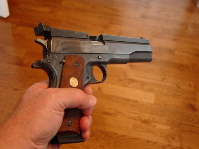

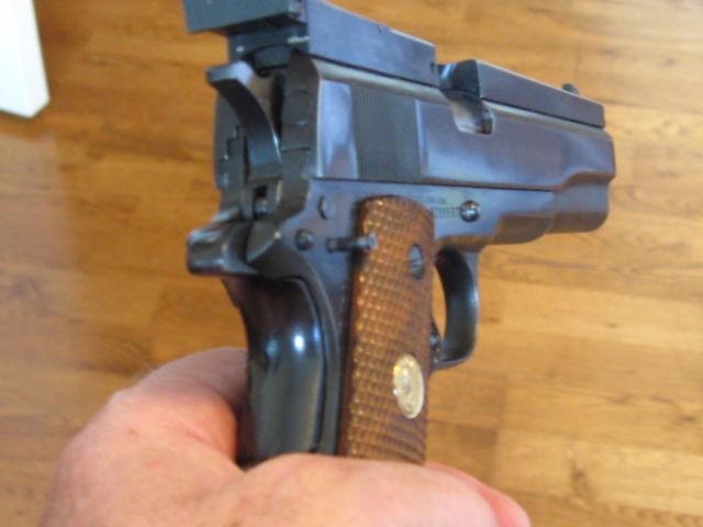

Hello folks,
I have one of Jim Sr.'s .45 Longslides from the early 80s, when I was just out of high school. It has the Louisiana address, and the date marked on the guide rail of the slide, his signature grip stippling and an Aristocrat rib. Shoots mighty well with 200gr LSWC at 50 yards. I search out his pistols after buying a Hardball model, and now have 3. This one makes me ask a question concerning original equipment on the 6" model.
I assume these were made for Pin matches, or possibly Bullseye? My question regards the Safety. Did they come with Ambidextrous safeties, or single-side only? This pistol, which functions 100%, has the forward pin sticking out from the side of the frame about 1/16". Doesn't affect function, but it looks wrong. Any ideas are appreciated.
Thanks for your help....Amanda

BEA,
I found out today that the previous owner had put the safety/trigger pins in from the wrong side, and the pins were only working their way out of the pistol, since they did not have a ridge to keep them in place. I stripped the pistol and reversed the pins. all is good now. The long slide was set up for wadcutter loads. The Aristocrat Rib is very similar to the Bomar, but it does not have the "tuner" function. I have one of his Heavy slides and it has the Bomar for a red dot, as well as the iron-sighted Bomar. Mr. Clark sure knew how to build an accurate pistol. If you look the two pictures of the gun you will see the two Pins, right behind the right stocks.
Thanks for asking about it.
Amanda
Amanda

Just for reference those are called the hammer and sear pins. If you ever have to order new ones you will need to know the proper names for them.
In the picture that's the sear pin working it's way out from being installed backwards. And from the picturre the hammer pin is also installed backwards. Best to correct that before it backs out also.
I just got done working on a friends Clark Long Slide. Nice accurate guns.
Enjoy!
Kirmdog
Enjoy!
Kirmdog

Clark Long Heavy Slide Safety Question
Thanks for the help! I stripped it down and reversed the two pins, and they now look right and function correctly. Bueno!
Amanda
Amanda
