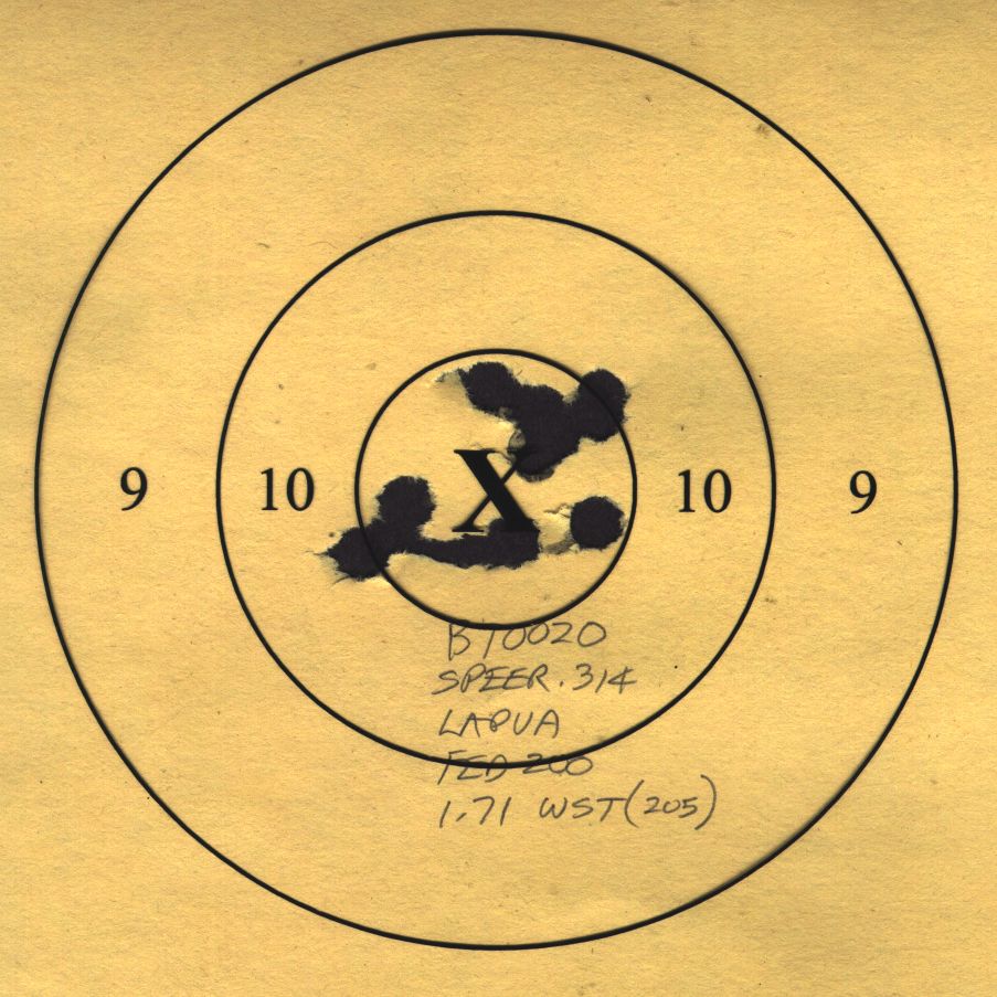

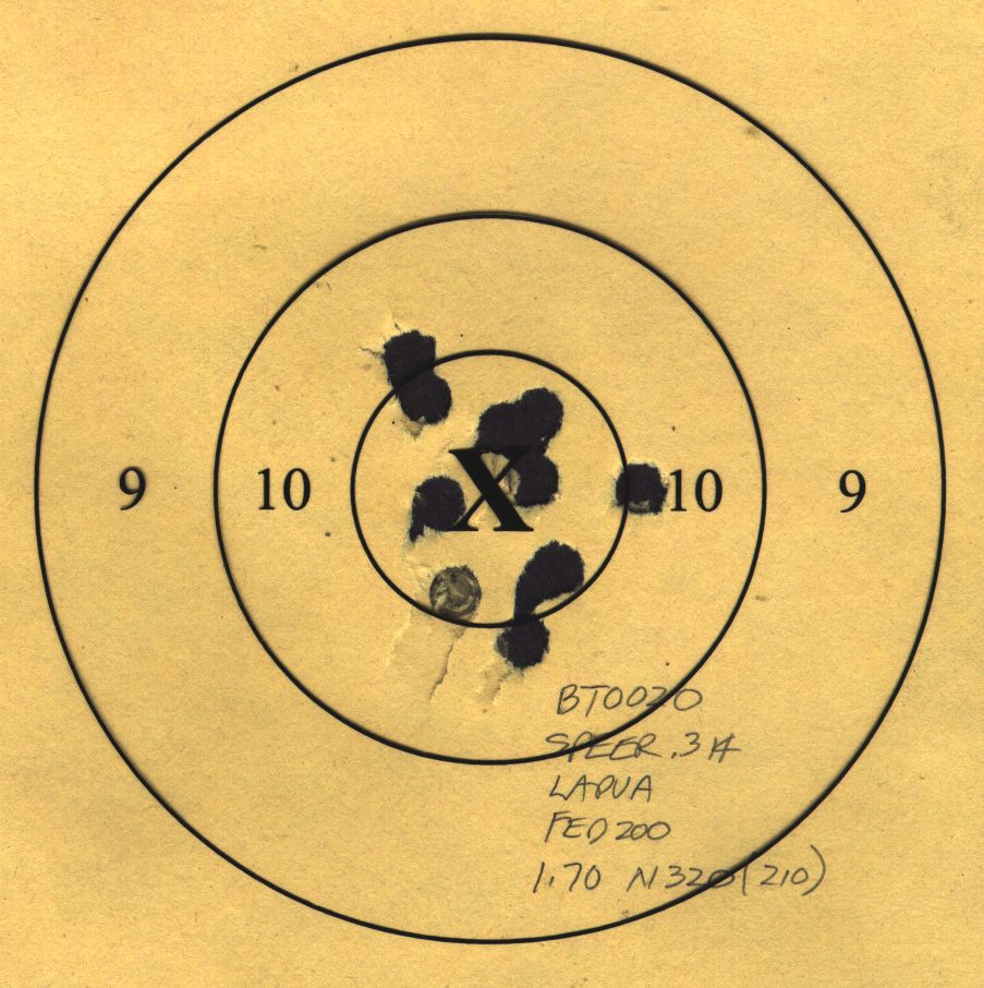

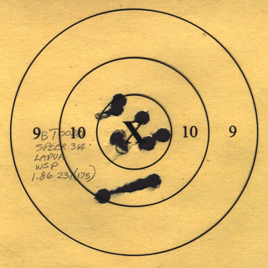

Several folks have written me about the accuracy potential of the 32 WadCutter at 50 yards for NRA style shooting.
Well, a photo is worth a thousand words and I am attached several thousand words in the form of scanned targets from my last barrel project.
The barrel is a Shilen stainless steel, 0.311" six groove, with a ten twist.

The flier on the last target is reality. It could be caused by a bad bullet, split case, erratic primer, etc.
These fliers also occur with the expensive commercial ammo.
The purpose of my test targets is to verify that the barrel is capable of shooting well. The next challenge is reloading ammo that has no variations whatsoever. I am not there yet.

It is common for the .32 to throw flyers. In 100 shots the .32 will put 1 to 2 shots 30 to 50mm out of the group and in any direction.
The problem appears to be the thin wall of the case and variable case release neck tension.
One solution is shoot new cases all the time or neck anneal every time you reload.
If you shoot a revolver, using a button nose projectile with a heavy roll crimp in the crimp groove will help. The wadcutter auto is a problem.

Yes, the bullets are Speer 98 HBWC. I go through the box one by one and select the ones that have the fewest defects. Sadly, they are not as well formed as the early ones with the wax lube.
I use Speer as they are readily available, made in the USA, and reasonable in price. H&N, in my brief testing, has performed much better. Unfortunately, they are rather pricey. Good news is that they are available in different diameters (0.312" - 0.315"). The Speer bullets vary in diameter from 0.312" to 0.314" in the same box with 0.313" being the average.
Dr. Darius "Doc" Young recommended and shot the H&N when he was shooting. (0.312" fired in a Hart 0.308" barrel) He sent me some test targets which were most impressive.
Looking at the Speer bullets I get the impression they are tumbled after swaging during the lubrication stage. I have a swaging die set of my own and my home made bullets come out exactly the same diameter with sharp edges. Also the weight is +/- 0.1 grain. (Very labor intensive process, I find it easier to sort out the Speer Bullets)
