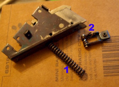

I have the same problem: Fas 602 light strike.
Initially the pistol function like a dream, last training 300 rounds without any failure, the match soon after, less then 30 rounds and.. 1 bang 1 click... I have cleaned the pistol before match and also during match.
With various type of ammo (sk, lapua, rws, s&b) same light strike.
One piece at a time, I tried to change:
- hammer box screw.
- slide spring.
- firing pin and its own spring (firing pin hit the brass in the right way).
Chamber is clean.
This afternoon, as before one bang one click...
So i dismantled the hammer box (see below):
1. Hammer spring lenght is 31mm.
2. Pressure plate spring.
It's the last chance, tomorrow i'll go to buy and replace.
LukeP.

- Fas 602 Hammer Box
- p6243624.jpg (32.57 KiB) Viewed 6954 times

Have you checked that the new firing pin is long enough (able to protride from the slide face by more than is needed to hit the cartridge properly) and the correct shape.LukeP wrote:Replacing literally all spring, and firing pin, don't fix the light strike. Today 3 out of 60 shots, in match.
Are you certain that the inside corner of the case recess on the slide face is perfectly clean. If you just use a toothbrush then you will get a buil-up there which needs to be scraped out with a knife point or very small screwdriver.
Failing that, have you tried getting a good gunsmith, experienced with FAS, to have a look. I am certain there will be others but the only one I know of who is still working is Viktor Odermatt near Zurich. Do FAS still have any of their technicians.
Thanks David,
yes i performed several times this check.
I also tested this brand of ammo: Sk, Lapua, Rws, Fiocchi, S&B, and always have a light strike every few rounds.
Last thing is removing estractor, it's the only thing i not tested.
I have also 4 magazine, and no difference among them.
I'll expect italian championship and put the pistol in Domino hands.
