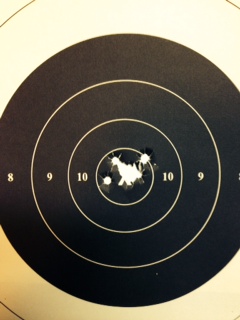

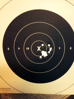

These are two 10 shot targets shot at 50 yards with Old Casters's bullet.
- 50 yd 32 acp pmc brass.JPG (33.84 KiB) Viewed 8596 times
- 50 yd 32 acp winchester brass.JPG (32.02 KiB) Viewed 8596 times
Re: Pardini HP 32, ammo talk
Now those targets have really caught my attention! This is the Tight wad load?
Those groups are from the info I submitted prior with TiteWad.
From a rest, I presume?pistol champ wrote:These are two 10 shot targets shot at 50 yards with Old Casters's bullet.
- Posts: 132
- Location: Eastern PA
Yes from a rest. I'm a high master but I'm not that good.

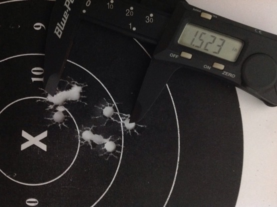

I do not have access to a ransom rest, so I use a bench rest with my Aimpoint 4 MOA red dot. I know it's a good hold because I can duplicate ethe results. Today I ran some Old Caster designed bullets again that I casted. Similar specs to what Pistol Champ posted in regards to the loading. Mine were 0.870 oal, 0.333 crimp, with 1.7 on VV N310. Didn't set up the Chrono either. But I shot almost 100 rounds. Largest group was about 2 1/2" (again, off the bench) with usually 8 out of 10 under 1.5". The last two groups were under 1.6" and the 5 shot strings were grouping together so I would bet a paycheck out of a ransom rest these would be closer to 1" groups.
My bullets drop close to 0.316 from the mold. I size them to 0.3148". Alox lube. Once fired Hornady brass.

I hope someone starts to manufacture this bullet commercially so others with this gun can enjoy the accuracy.
I happened on 16 pounds of Titegroup so I tried it in the 32. I used 1.3, 1.4 and 1.5 and the 1.5 was the best. I tried the Titewad and got better results with 1.2 grains but not quite as good but almost as the Tightgroup or 231. All of these including 1.7 231 give me groups in the 1.5 inch for 10 shots with the typical 1 or so flyer that makes it 2 to 2 1/2 inches. I sometimes get 10 in a row with no flyers but as long as I group mostly in the 1.5 range I am happy. Of the three powders I would go for the fastest, Titewad first and Tightgroup second because they are probably cleaner but you may have to use what you can get.
