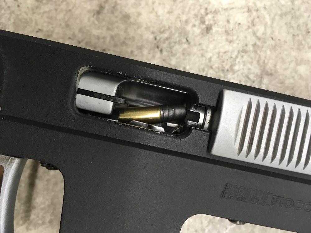

A bit older Pardini here.. What causes it to feed like in attached picture?
I have replaced all springs in the bolt (recoil-,firing pin- and extractor spring) also replaced magazine spring and installed a buffer.
Tested with CCI std, SK Standard and some Winchester ammo. Same problems..
Re: Pardini Questions and Answers
Which round does this, or is it random?
Same problems with CCI std, SK standard and Winchester. SK´s failed to eject properly, too.
I have found my (older) Pardini SP feed issues are always solved by stripping and cleaning the mags before shooting, now "any" ammo works.
John.
John.
I was going to recommend a good cleaning as well. Pay particular attention to the front of the magazine follower ("elevator") and the inside front the of the magazine. Crud built up there will tend to tilt the follower up in the front. The wax lubricant used on some ammo can deposit a pretty stubborn layer inside the magazine, especially in front.
It's still important to know if it always happens with the same number of rounds in the magazine (1 through 5). If it always occurs at the same round count, it's a strong indication that it is magazine related. Can you borrow another magazine to try? The ones for an SP that old are different from the present design, and I don't know if the old ones are still available. The big difference is the length of the "feed ramp" (tongue) that sticks out in front. The newer magazines are a little longer there, and may require some careful filing to get them to fit in the shorter notch in the older frames. I haven't tried this "conversion" myself, so I don't know how well it would work.
Ok, thanks, I´ll try cleaning the magazines really well.
Feeding failure never happens on the first round, I´m not sure, but I think 4th and 5th round get most failures.
It sounds like a magazine issue. The 5th round is the only one supported by the follower, and not another round underneath, so it behaves differently.

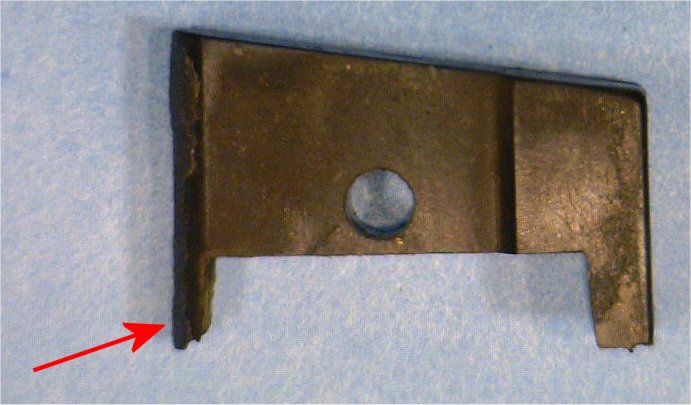

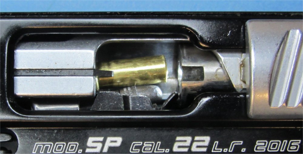

I'm working on writing up what I've discovered about 4th round trapped brass jams, which can be caused by a combination of a weak extractor grip, dirty or fussy magazines, and the vintage of the bolt. Basically, if the magazine and/or the bolt aren't right, the bullet of the 5th round tips up and knocks the 4th round fired case loose from the extractor before it can hit the ejector solidly.
It looks like this, just before the fired case hits the extractor:
The bolt design of your vintage of pistol should be OK, and the failure you are seeing is different, but it illustrates the sort of thing that can happen. One other thing to check is that your magazine follower isn't badly worn or broken, especially at the lower front. I took a close look at the photo of your jam, and it looks like the front of your follower is coming up too high. It shouldn't stick up above the metal on the front sides nearly that much. The plastic is very thin there, and it helps prevent the follower from tipping upward too much. I've never seen a broken one, but it's possible.
- Pardini SP Magazine Follower.jpg (53.67 KiB) Viewed 7012 times
Gwhite, thanks for those photos!
I have two magazines for this pistol. One very well used, other not so much. Neither of them have that plastic tab you marked with arrow. I didn´t think anything is missing until seeing that picture and taking a closer look. There is clear markings on bottom of the followers that those tabs were there but have cracked off.
They aren't exactly cheap, but the current replacement followers should fit your older magazines just fine. My wife has an SP only a bit newer than yours, and I've replaced one of her followers with a new one. Your pistol is old enough that the plastic may have gotten brittle. That thin section probably gets flexed a tiny bit every time you shoot a magazine.
Someday when I'm bored, I'm going to try to 3D print some spare followers. I can't print that thin section in front, but I think I can add material in the back to prevent the follower from tipping up too far in front. The thin section also guides the spring from in front so it doesn't bind, but a plastic boss in the middle will do the same thing. I've already printed a bunch of the bottom latching plates after launching one across my shop. It vanished for several weeks before I stumbled across it in my reloading gear.
