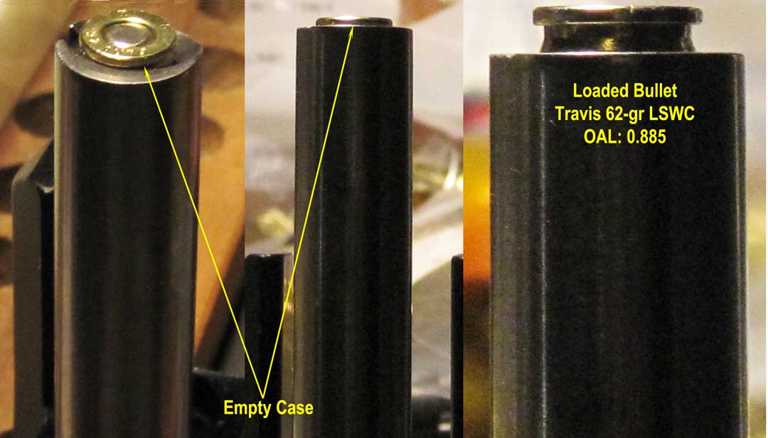

Re: Pardini HP 32: OAL & Function
zipp0,
I stumbled onto the same issue re the OAL for the Travis 62-gr LSWC bullets. The problem began with a worn spring (a mag spring for a GSP 32 S&W L) that I cut and used as my 32 ACP mag springs, to solve the initial spring issue (failures to feed, stovepipes) as discussed by Oldcaster early in this string. I thought it better to cut a GSP spring than my Pardini springs...
This sad saga began with the first alibi I've ever had with the Pardini SPBE 32, a failure to eject. The problem was worn GSP springs; specifically, the end where I had cut the spring wire end had worked itself around the follower and was sticking. So, with the approaching regional Dixie Match, I decided to replace both springs and used the original springs magazines and conservatively cut 1.5 coils. A litter stiffer than before, but ought to work (probably should have gone with two coils).
About the same time, I discovered a box of initial loads of the 62-gr LSWC that were short (0.852 OAL). I tried a few at the range and they shot into a slightly enlarged hole at 50 yards. Whoa, serendipity knocks I thought, maybe I'm on to something. And then my lizard brain kicked-in: geez, I wonder if I could just resize the OAL of all the 0.885 rounds...
DON'T DO THAT. DESPITE INTERNAL ALARMS, GUT FEELINGS, DON'T! Well, I did, to about 200 loaded rounds, which group like buckshot (well, not that bad).
That brain fart led to the synchronicity of short bullet meets a little too stiff spring, and viola, the stovepipes are back, usually the middle bullet in the 5-round magazine. I decided to shoot the re-sized bullets rather than pull them and start from scratch.
At this point, I noted your comments on using the short bullets. So, I'm getting ready to do some more load testing, using wimpy springs. I'm also playing around with the 75-gr Rim Rock bullets and WST and TiteWad.
The OAL issue should have been self-evident if I had just put an empty brass in the barrel and compared it to different OALs of loaded bullets, the issue would have been glaring. I've known the 0.870+ loaded bullets were a little long, and that once loaded into the breech, they could not be unloaded; rather, they had to be shot. A better bullet design might be use base of Oldcaster's design with a RNFP (similar to Rimrock) to give an OAL of ~0.900. The base of the nose would need to be ca 0.311. Unexpected loading issues and summer's nearly here, jeez, dipnet
