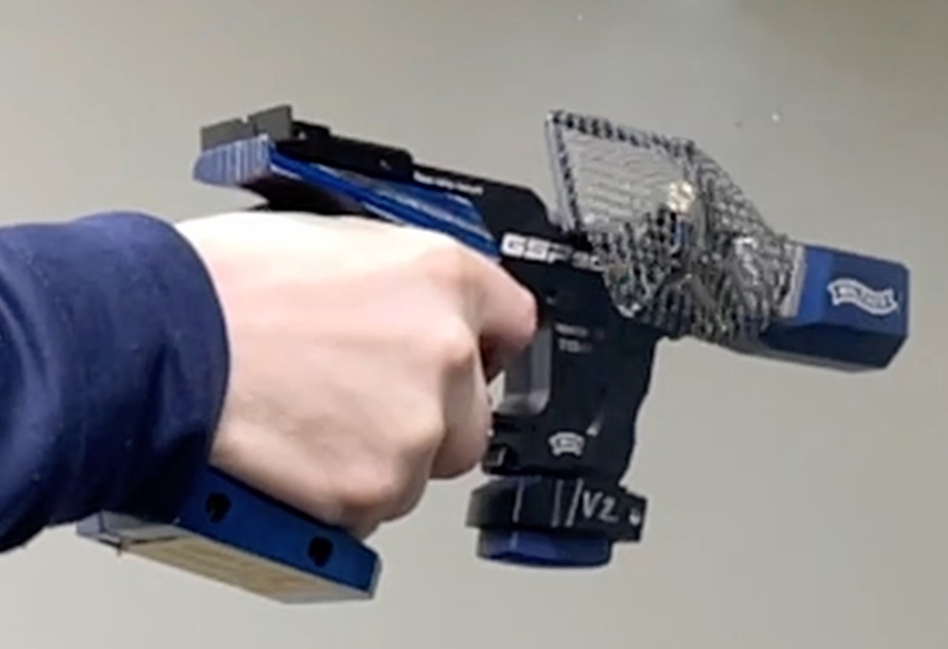

Jeff-France
Posts: 17
Joined: Thu Mar 26, 2020 7:54 am
Re: GSP500
Post by Jeff-France »
Bonjour from France,
I'm looking for a GSP 500 cal .32 owner to get sizes/dimensions (in metric) of this gun, i already design a Hammerli SP20 .32 brass catcher and as i think they make it on the SP20 Basis, same magazine it seems, i need to check if i could adapt or use the SP20 catcher to this one.
Thanks in advance for your help.
JEFF
fc60
Posts: 759
Re: GSP500
Post by fc60 »
I wrote to Walther and they confirm the magazines fit the Haemmerli 280, SP-20, and GSP500. The only caveat was the blue magazine cap.
Good question about the case catcher. I look forward to other replies.
Jeff-France
Posts: 17
Re: GSP500
Bonjour, some news,
I finally found somebody to develop the case catcher for the 500, a reseller in Sweden... it's in progress, we're on the second prototype, the first was not sufficient with 60% results, i'll keep you informed when i got the new results.
Cheers
Jean-François

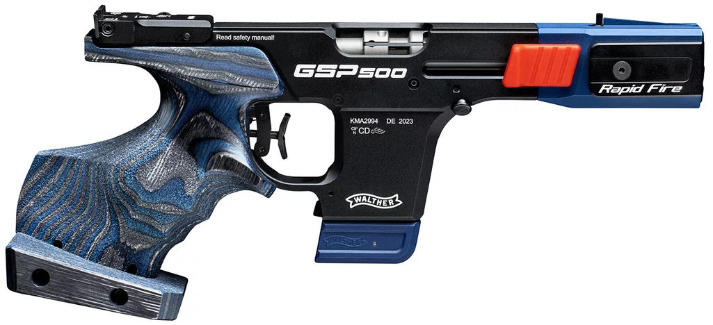

new GSP500 Rapid Fire variant announced:
https://carl-walther.com/sport/products/p/2877848M

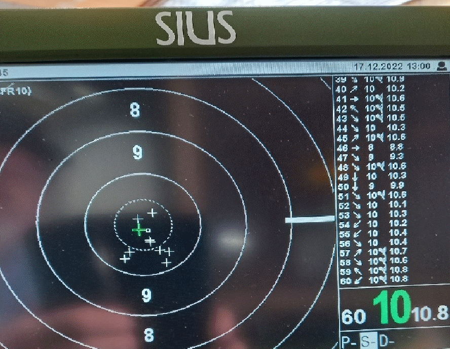

Here are my notes after 18 months of shooting the GSP500. The pistol is highly recomended and I think better than the Pardini in some small ways.
Thinking about getting the .32 barrel add-on in the future.

Ammo Testing
Chronograph Results - 15 round sample, Fastest to Slowest
Brand Average Extreme Spread Std Deviation
Geco Semi Auto 294 m/s 17.3 m/s 16.2 m/s
CCI Std Velocity 284.3 m/s 15.9 m/s 13.5 m/s
RWS Target Pistol 269.6 m/s 26.1 m/s 23.0 m/s
SK Std Plus 257.5 m/s 36.5 m/s 26.1 m/s
SK Pistol Match 251.0 m/s 28.3 m/s 26.5 m/s
Chrono results show 6-7 m/s faster for same ammo than Pardini (SK Std+ now safely passed)

Hi, some news of the catcher.
After many months on research and tests (7 prototypes), the catcher is ready (see video) with only one restriction, the standard cartridges like Lapua have a charge that is too powerful and are ejected hazardly.
The majority of shooters use a load between 0.09 and 0.08 grams of BA10 powder for reloading. It is with these parameters that we got the results of the video.
https://youtu.be/6WCfp-5kSgU
Cheers
