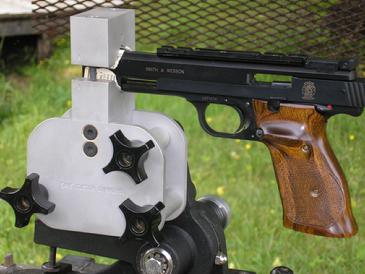

David sams sells these.
- 365_P5280365.JPG (19.78 KiB) Viewed 5391 times
