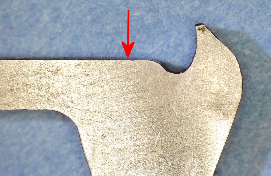

You can do a lot to check over your extractor system while you wait for a new ejector. One possible quick fix is to the check the gap behind the extractor hook. I use tapered feeler gauges like these: https://www.amazon.com/gp/product/B07B3TQQSV. The depth of the slot is usually pretty accurate, and is roughly equal to the rim thickness. If you measure the gap between the hook and the face of the slide, it works best if it's around 0.004" to 0.007". If it's bigger than that, I use tiny shims behind the rear "foot" of the extractor to tighten up that gap. Even without a feeler gauge, you should only be able to tilt a fired case a small amount to the left if the gap is right.
You also want to make sure there is enough "deflection" when it holds onto a case. When a case it slid up under the hook, it should push the extractor to the right slightly. Case & rim diameter vary from round to round, and brand to brand. You need to make sure that you have a good grip on the smallest case you might encounter. It's a bit tricky to measure, but I try to make sure I have at least 0.004" of deflection on the smallest case I can find. To increase the deflection, you need to stone down the "throat" of the extractor:

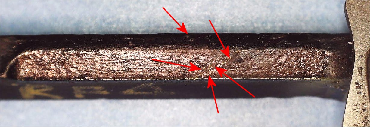

If you put black marker on the throat, you can assemble things & push the extractor back & forth from front to back. That will identify the high spot where the extractor is hitting the inside of the slot in the slide. The extractors are hard, and it can take some serious stoning to add much deflection.

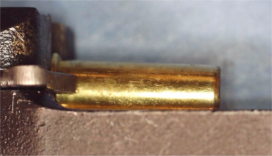

The most common symptom of a poor grip on a case is trapped brass after the last shot. What's different on the last round is that there's nothing in the carrier. That allows a poorly held case to droop down, and hit the slide rail on the way out. If you clip a case under the extractor, and push down on it gently, it shouldn't be able to droop much below horizontal. Here's an example of too much droop:
