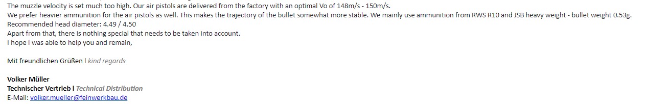

Feinwerkbau also recommends the 8.2 grain pellets (at ~150 m/s), see attached email reply to a question I asked in July 2022.
Weight related POA/POI shifts might be pistol dependent, and will certainly be speed related. At 10 meters they will likely be small.
I think everyone needs to see for themselves.
