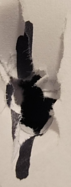

kqrxbn wrote: Sat Aug 26, 2023 10:46 am Not as much feedback as I had imagined. Do my fellow shooters never find themselves stuck? 😃
I started shooting straight lines, instead of circles, made me super aware of my wobble and helped a great deal. Great feeling to punch holes the length of a I inch black line.
hth
M.

"I started shooting straight lines, instead of circles, made me super aware of my wobble and helped a great deal. Great feeling to punch holes the length of a I inch black line."
I never shot on a straight line before, but did holding drills on both vertical and horizontal lines. Is the purpose to shoot on the line and stack them or try to make it in one spot on the line. Would it be good to shoot on a horizontal line also.
Stan

porkchop wrote: Fri Dec 08, 2023 9:42 pm
Stan
Either
The point is control of point of impact. Make it fun!
The mental reward will further motivate.
