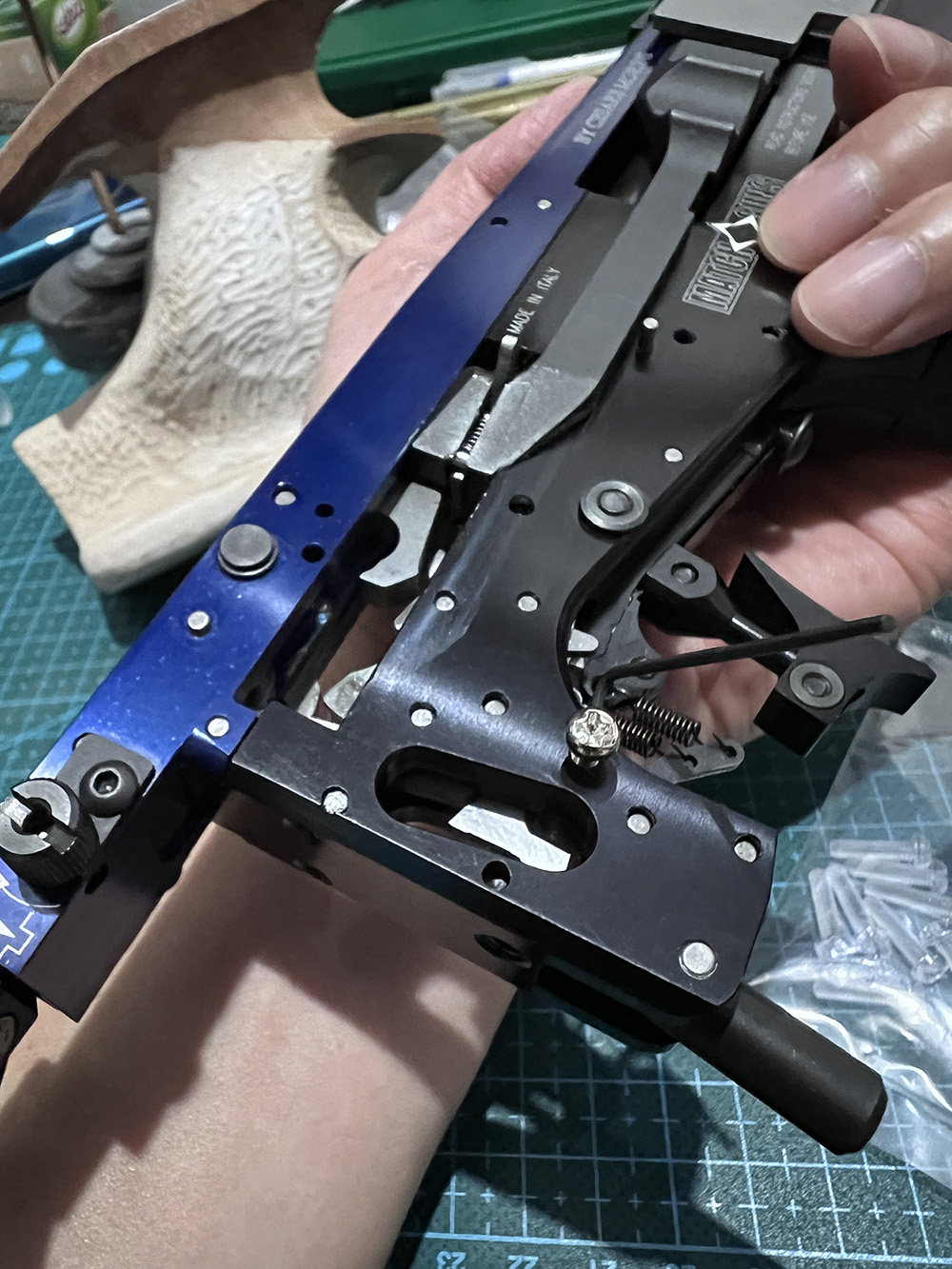

Good news~ @ GWhite. My theory worked. I used a steel screw to stop the outer screw spinning while doing the inner screw. I tried nylon screw first but it’s not strong enough to stop the spin. For the steel screw I was really careful to put the pressure in as you said it may chew up the threads.
Now I’ve perfect 1005g trigger weight.

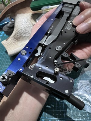

here is a photo showing the screw I used to stop the outer screw spinning.

You want to have something to prevent the trigger screw from shifting from firing vibration & repeated trigger operation. You can mimic what the factory apparently left out of your pistol Shave down the end of a nylon screw so most of the threads are gone. Then cut ~ 1.5-2 mm of that to put in the hole as a soft plug and back it up with a steel set screw.
I could be wrong, but I think the locking screw on my pistol is on the left side, the way it's shown in the manual.
