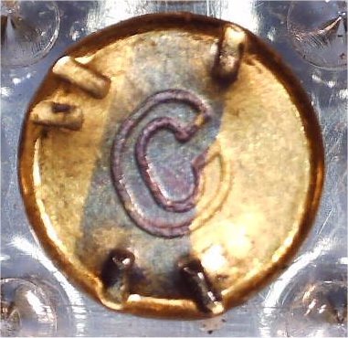

They also re-did the design of the boxes a bit. It looks like this:
They had a deal with Eley for many years, and licensed their priming technology from them. The boxes used to say "Eley Primed". Apparently that deal expired several years ago. Since then, the boxes say "Aguila Prime", but I've shot plenty and it's every bit as reliable as the older stuff.

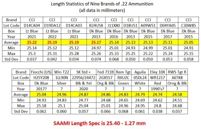

A quick update on CCI: I just got two new cases for the college team. I fished out a box of 50, and I will examine it for excess wax & length statistics. I'll report back in a few days.

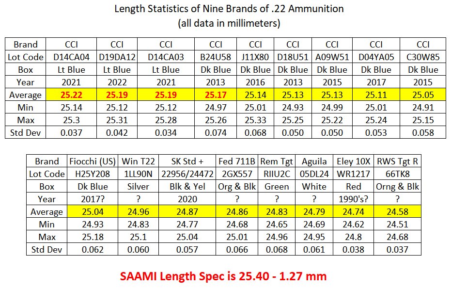

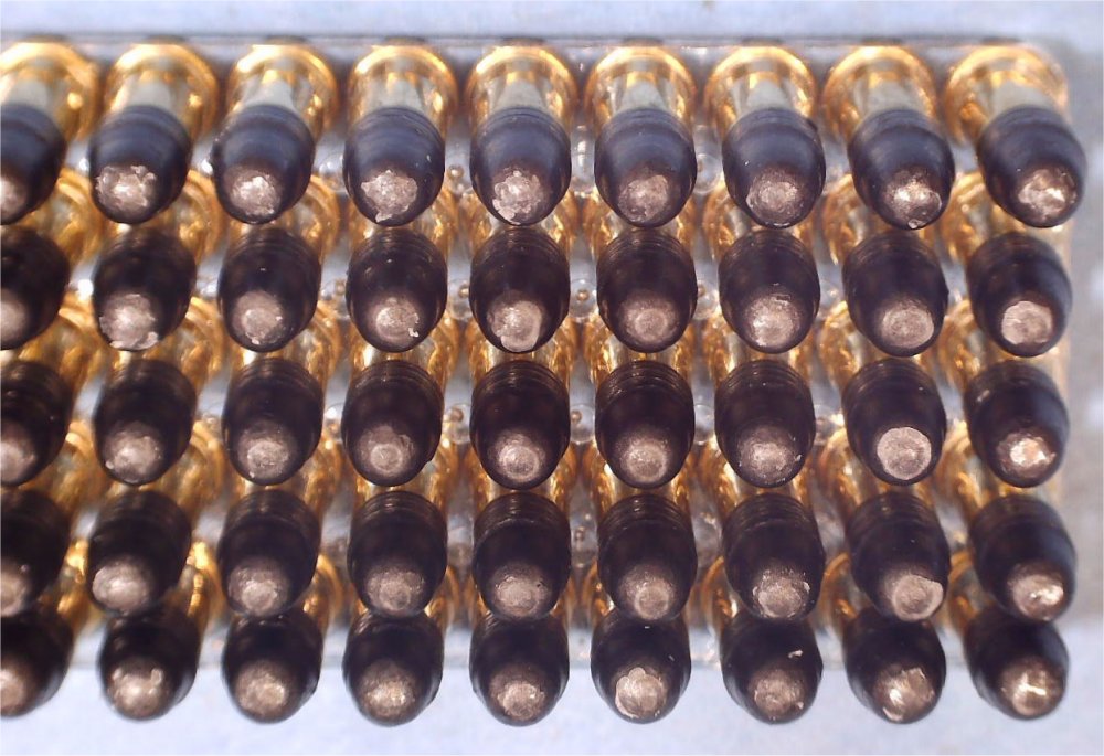

I just finished measuring a box of the latest lot of CCI ammo we got for the team. It's just as bad as the last batch. The box I grabbed isn't as waxy, but I'm pretty sure the length is still going to cause problems feeding from the Benelli & Pardini magazines.
Here's a picture of what the wax looks like:
There's definitely still more wax than I'd like to see, but it's concentrated at the very tip, without adding to the length. There are thin flat disks of wax on the tips of quite a few rounds. It almost look like the tip were resting on the bottom of the box (or something similar) when the wax hardened. It's even possible the ammo was stored or transported when it was hot enough that the coating softened & flowed down a bit.
And here's an updated table, with the newest stuff ranking 2nd longest:
Now I have to figure out what to do with 20,000 rounds of ammo we may not be able to shoot reliably. This is certainly the last time we will buy CCI until I have proof they've fixed the length problem. I will try some in my personal Benelli & Pardini to see just how bad the problems are.
