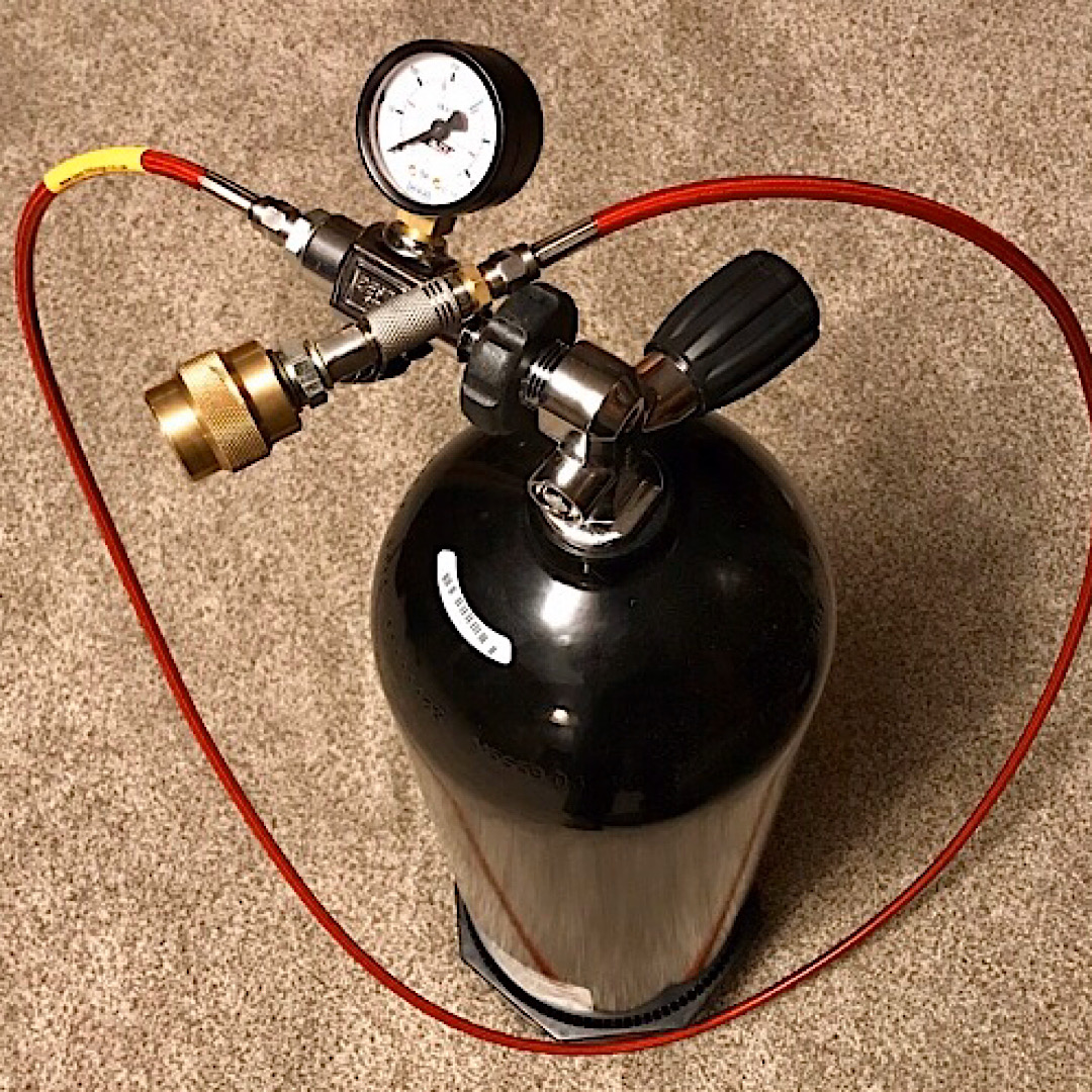

Posts: 647
Air Supplies and Fittings
Hello-
If you do not want to look everywhere you could buy this tank from Champions Choice-
http://www.champchoice.com/store/Main.a ... s&item=S80
One does not need a pressure gauge, if they stick with a 3000 psi/ 200 bar tank. It can be nice to have, though. With a charging kit you can purge the air before removing the cylinders, reducing stress on the aluminum cylinder threads. The charging kit also makes it easy to switch between different adapters, for more functionality. Those items can be sourced from BEST fittings. A charging kit, and some quick coupling adapters will be needed, for ease of use.
Charging kit- (1/8 BSP)
https://www.bestfittings.co.uk/shop/air ... ton-bleed/
Quick coupler plug (QC) (1/8 BSP)
https://www.bestfittings.co.uk/shop/qui ... er-socket/
Adapter for quick coupler- (1/8 BSP)
https://www.bestfittings.co.uk/shop/qui ... pler-plug/
Female adapter-
https://www.bestfittings.co.uk/shop/fil ... -bsp-male/
The QC plug and adapter for the QC plug are not necessary, but nice to have. They allow one to switch out different filling adapters easily. If you do not get them the Female adapter will screw into the threads on the end of the charging kit hose. It will not be easy to remove, later, though.
All together, it ends up looking like the attached photo. (The hose in the photo is the 2000mm.)
Best regards,

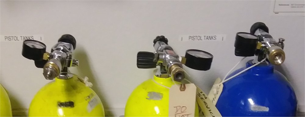

Posts: 3582
Re: Looking for a Match Pistol
You don't really need the hose. Best Fittings can supply the fill adapter with the DIN fitting stuck right on the end:
Cylinder Filling Station.jpg (45.91 KiB) Viewed 3564 times
We've got two tanks set up with the most common fill adapters pre-installed into the DIN fitting, and one tank on the far right for use with any fill adapter.
We have students filling cylinders, and for safety, we have a system that can NOT over-pressurize the cylinders. Unless you have a high pressure air pistol that can handle 300 BAR (4500 PSI), and are the ONLY person who ever uses it, get a tank with a K-Valve. That signals to the dive shops not to over fill things. I still get tanks coming back that are at 220 BAR, and I have to vent them down to 200 before the students get to use them.
Unless you are young & strong, I also find an 80 cubic foot tank to be WAY easier to haul back & forth than the 100 cubic footers.
Posts: 647
GWhite- agreed, the hose is not needed for filling cylinders. The value, is when one is charging something other then cylinders. A rifle, such as a Daystate can be charged directly at the port on the rifle, and held easily.
