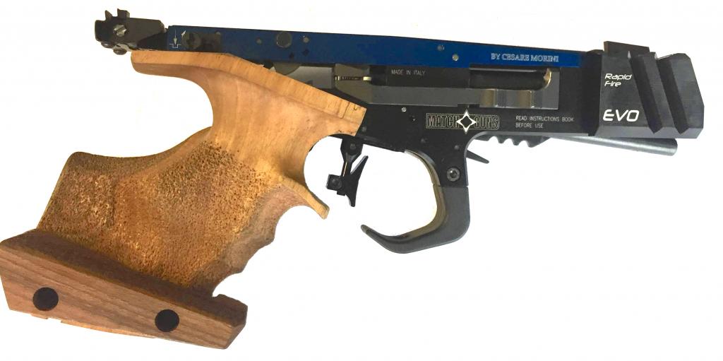

The picture you have shown is the standard version of the EVO. The grip seems to be from someone’s imagination as to how a MG2 evo may be adapted for Americans and definitely is not intended for ISSF shooting. The electronic version is following.
I have attached a photo of a MG2EVO RF manual trigger intended for ISSF shooting exclusively. Buy the RF as the recoil advantage from the angled spring loaded weights in the front is invaluable. I have the previous model electronic and I would also suggest the E.
The grip is adjustable to a greater rake angle than any other pistol.
