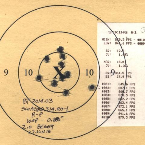

Tales From The Barrel Tester
I have been experimenting with the 32 ACP in the last few years. Accuracy with the Hornady Jacketed bullet has been well established.
I purchased a mould from Accurate Moulds, #31-065H, as it closely matches the profile of the bullet that PardiniUSA recommends.
After a casting session using 20:1 Lead:Tin, culling begins. I first measure all the bullets with a micrometer to ferret out all the ones that did not fill the mould fully. I next visually inspected them as I grease them in my Star Lube Sizer.
I had quite a few "rejects" that did not pass the micrometer test. I did not want to melt them down and try again so I thought about swaging them. To do this, I weighed the "culls" for a target of 64 +/-0.3 grains. Next the sorted bullets were swaged to 0.314". I lubed the bullets in a plastic sandwich bag with the Lee Liquid Alox and let them dry overnight on a sheet of waxed paper.
I loaded the finished bullets in R-P cases with Winchester WSP primers such that the bullet "just touches the leade" of my PardiniUSA 32 ACP test barrel. I used 1.60 grains of VV n-310, as it performed best with cast bullets. Additionally, I loaded some test rounds with Bullseye powder.

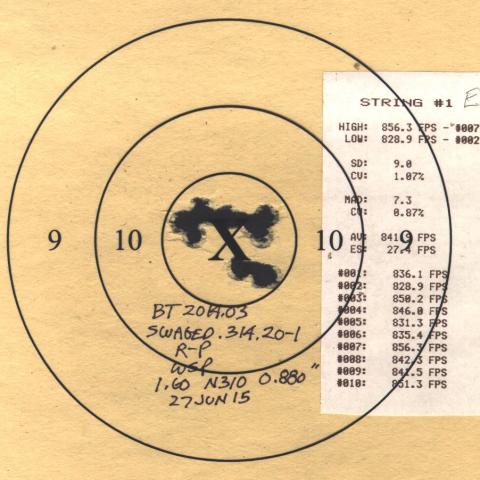

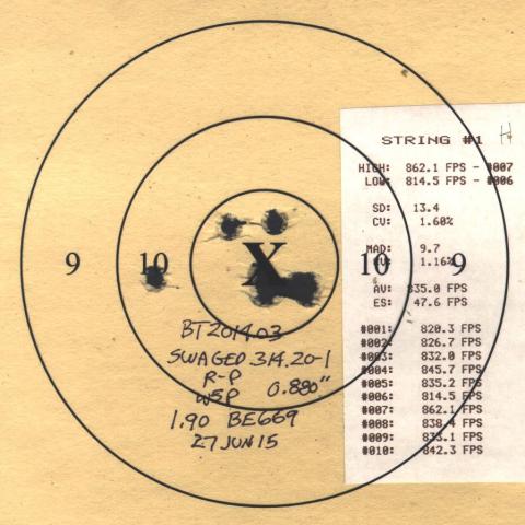

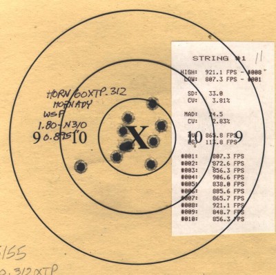

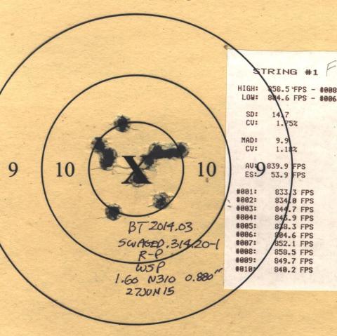

Attached are my test targets fired at 50 yards from a machine fixture.

I like that last one; what is that, 1.8" or less?fc60 wrote:Greetings,
You're doing yeoman's work. Thanks for sharing, Dave.

Greetings John,
The last target (314.2014.03.0035.small.jpeg) is actually the first ten rounds of the newly swaged bullet fired.
When I looked into the scope, I was pleasantly surprised.
I have swaged up the remaining reject cast bullets and the Alox is drying as I write.
I plan to load up another series for future testing to verify the groups were not a fluke. The encouraging note is that 1.90 grains of Bullseye produced the same velocity as the 1.60 grains of vv-N310 producing potential X-ring loads.
I also need to ascertain that barrel leading/fouling stays manageable.
Many chores ahead; but, now I look forward to my next testing session.

Greetings Bill,
Measuring the brass would be a major effort. Also, the fired case leaves a "bulge" where the feed ramp is located.
The 32 ACP chamber is "generous" in relation to the size of a loaded cartridge so the round may not position in the chamber the same each time due to gravity, dirt, burrs on the case, etc.
What puzzles me is the wide "Extreme Spread" in velocity.

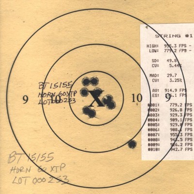

The first target is with Hornady Commercial ammo. New everything and a extremely wide variation in velocity. Could be a chronograph error?

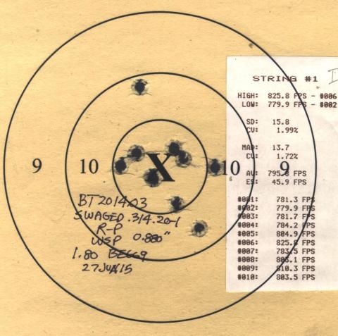

The second target is fired cases with Hornady jacketed bullets. Again, a wide velocity spread.
Both targets show the lowest velocity as being shot #1. After that, the velocities are fairly consistent.
I do not clean the barrel between strings. There is a time gap walking down range and back to change targets.
Being a one Monkey operation, I do not have time to watch each shot as I fire them. Besides, when shooting a Match, I have to accept the value of all the shots. i.e. no foulers as in Free Pistol.
Still, progress is being made.

After rebuilding my Ransom Rest base to fit my gun club's benches, I ran tests on the 62gr. LSWC (0.314 diameter) bullet developed by Oldcaster and manufactured by Travis Bullets. Florida conditions were far from ideal: temp was 98F and humidity was 95%. The loads I compared are in the attached table and include Hornady factory XTPs.
I achieved groups close to what others have reported with the best load being 1.60gr VV N310. I used Federal and R-P brass and Federal, CCI, and Winchester primers. The worst load was 2.30gr Titegroup using the 60gr XTP bullet. However, I have shot several clean targets in timed and rapid fire with that load and am surprised how much it opens at 50 yards. I shot the loads with the XTP bullets first and then the cast bullets.
For reference, the 10-ring at 50 yards is 3.36 and the X-ring is 1.695 inches. Cheers, dipnet
