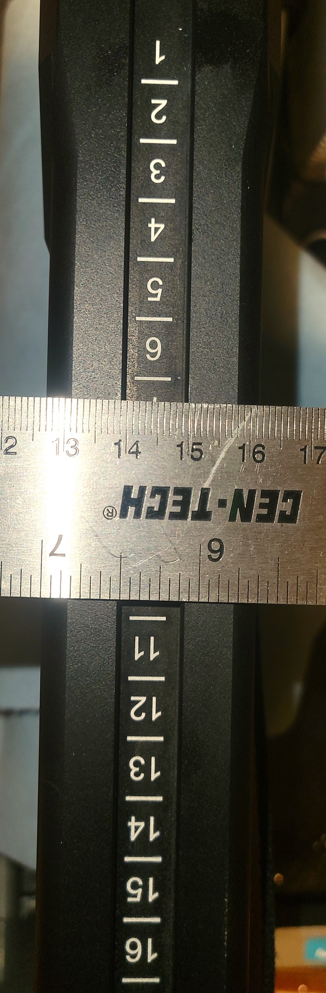

Anyone have a Tec-HRO Fanatic that they'd be willing to measure the forearm width on? I'm in the market for a stock to replace my Precise, and my number one complaint is the forearm width: it's narrower than I'd like but finding an alternative that isn't $3000+ has been a challenge.

Post by SRay53txtn »

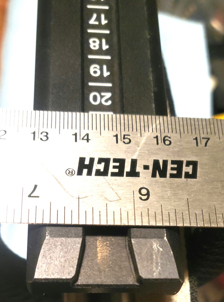

I have one - will get you the measurements this afternoon.
Hope this helps.
Ordered mine from Oberleenterprises in Oklahoma:
https://oberleenterprises.com/product/t ... -series-1/

mtncwru
Posts: 451
Location: San Diego, CA
Re: Tec-HRO Fanatic Forearm Width
Post by mtncwru »
Extremely helpful, thank you so much!

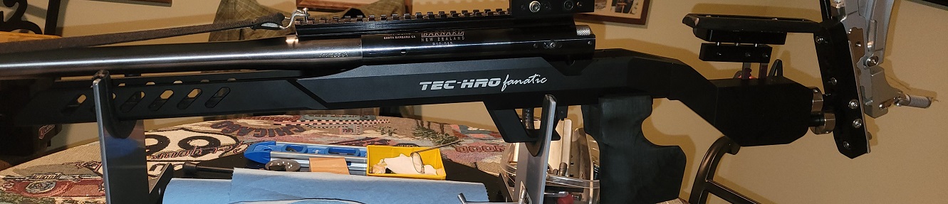

I have had three different barreled actions in it, Anschutz 2013, Walther KK500, and Barnard P for my Palma/center fire mid/long range activities. The Barnard setup is what is pictured. I made some changes to cheek piece & butt plate to get it to fit me and am very pleased with it. I also have an Anschutz Precise stock that I like for my smallbore rifle, purchased the Tec-Hro, so I could have it be my center fire setup. Only used for prone.

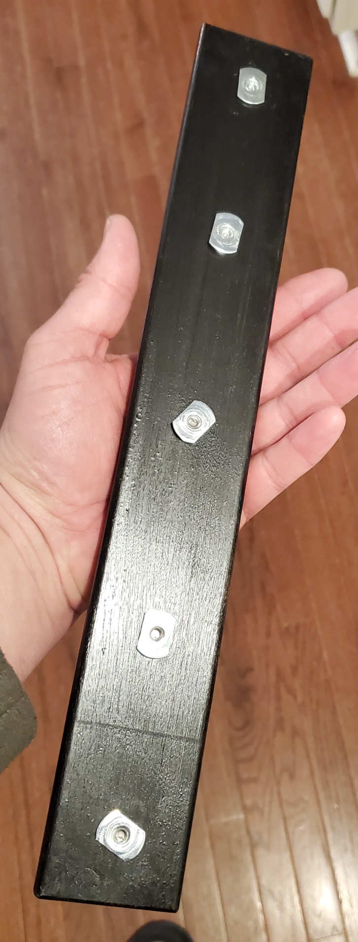

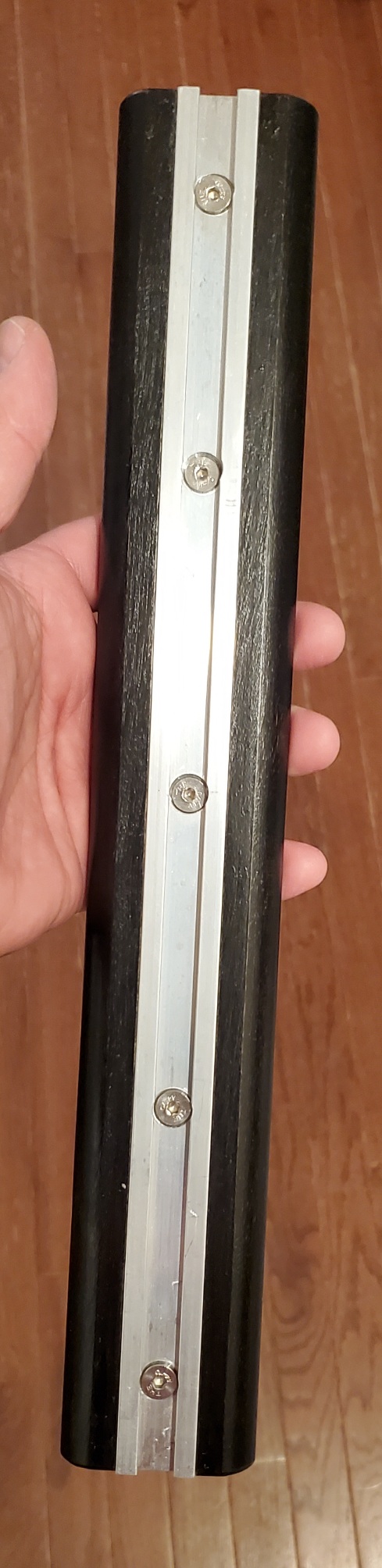

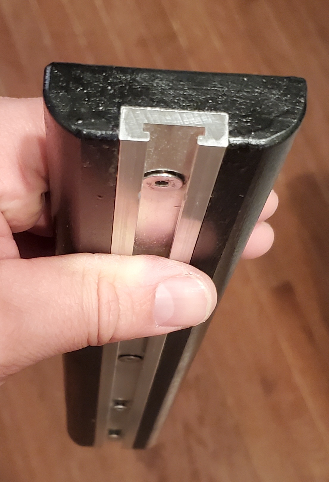

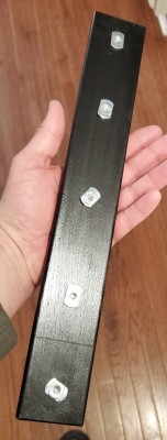

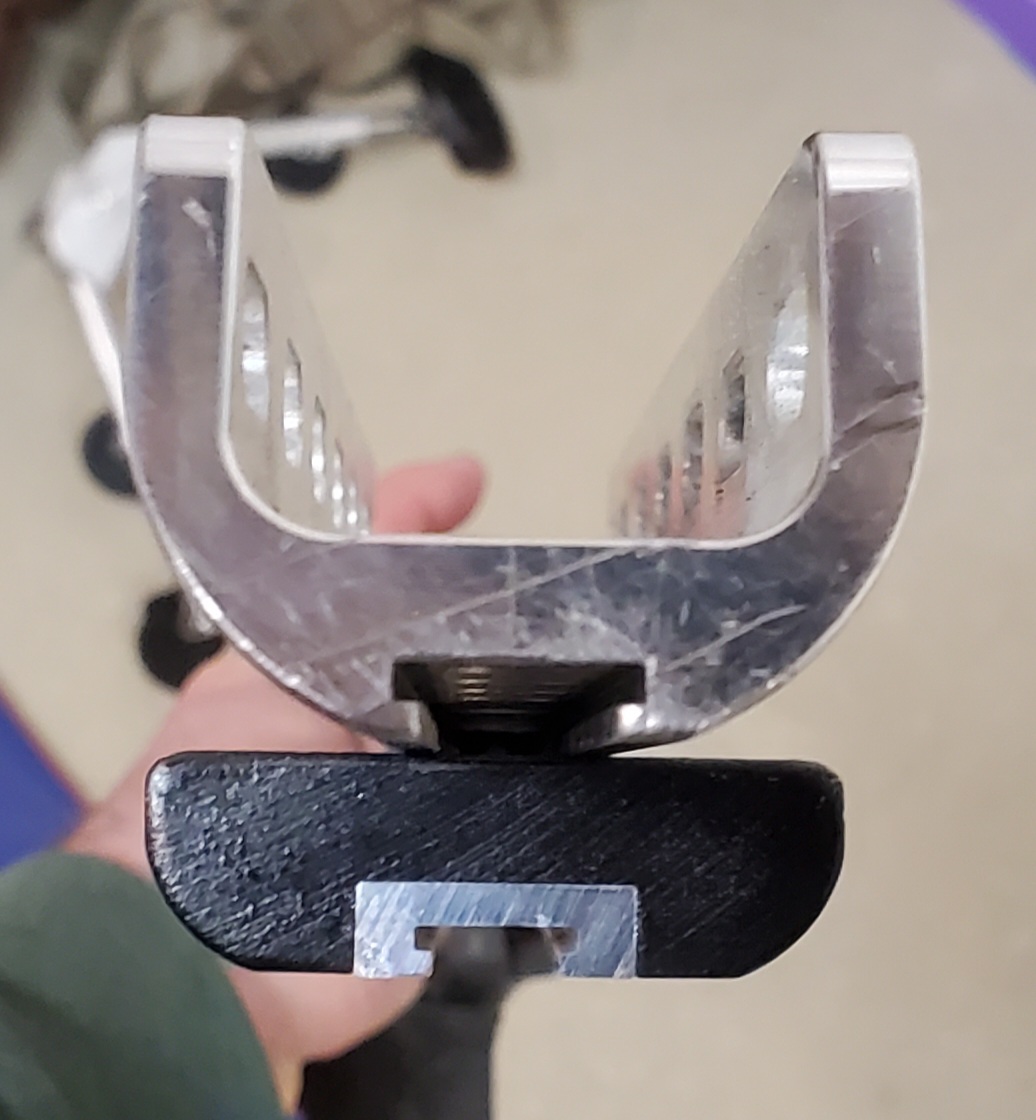

Another option to increase the forearm width or change the corner radius is a bolt-on forearm section.
I've made a few for guys that preferred the height and corner radius feel of an 1813-style forearm over their Precise stocks. The last one I made was for a Fanatic stock. Depending how you orient your support hand, the relatively small radius corners of the Fanatic can really hurt.
If you're interested, PM me. The ones I make use T-nuts to mount to the existing rail, AND have a section of Anschutz rail for mounting a handstop on the same surface your hand touches.

1845greyhounds wrote: Sat Oct 26, 2024 3:27 pm Another option to increase the forearm width or change the corner radius is a bolt-on forearm section.
Ah yeah, those squared-off corners were also giving me pause. I appreciate the suggestion and offer! I'll keep that in mind as an option.

1845greyhounds
Posts: 105
Location: Fishers, Indiana
Post by 1845greyhounds »
'Dude,
Thank you. You can get blank rail from Freeland or replacement Anschutz rail with scribe marks and holes from Champion's Choice.
https://freelandssports.com/product/ans ... ection-15/
https://www.champchoice.com/mc-firearm/ ... rts/003297
These T-nuts fit in the Anschutz rail profile and work well for coupling things.
https://www.mcmaster.com/90594A320
