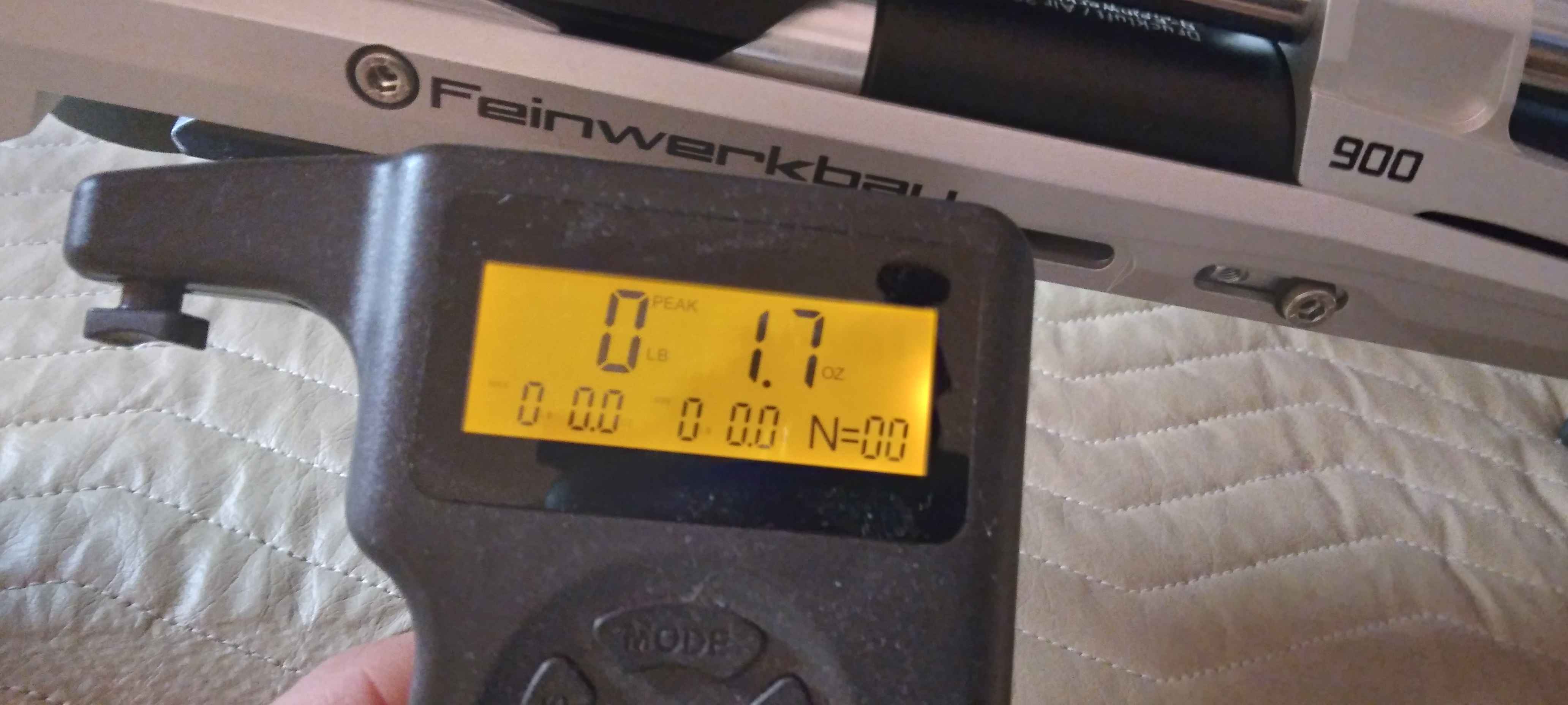

]The FWB 800, and 900. set at its minimum. 1.7 to 1.8 ounces= 48 to 50 grams
The last thing I do is put my finger on the trigger.
