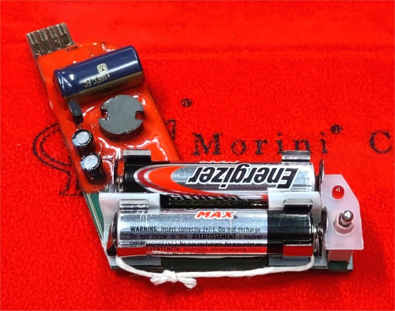

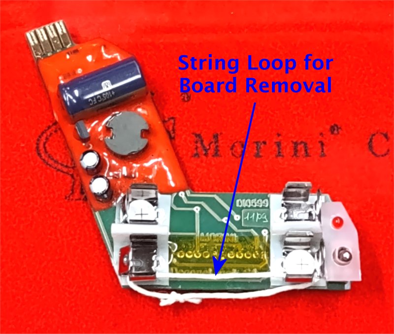

One problem with the 162EI is that a fair amount of force can often be required to change the batteries, which can flex the board. We have some with Rink grips, and I've had to whittle the inner compartment so that you can get the board out without a scary amount of force. The spring clips that hold the batteries are pretty strong as well.
One thing that helps is to make a small loop of string that goes through both ends of the bottom battery holder so you have a "handle" to extract the board. It applies the force at the base of the battery holder. and doesn't flex things as much. If I get a chance, I'll take a picture of one when I'm coaching tonight.

I finally remembered to take pictures of the string board-extraction loop I have been putting on our Morinis. The college team I help coach has six 162EI's, and every time I work on one, I add the string if it doesn't have one. The string is just one from the repair tags we have lots of. It's about the right length, and is sturdy cotton twine. The loop goes over the bottom spring clips for the lower battery:

Gwhite wrote: Sun Dec 17, 2023 8:52 pm I finally remembered to take pictures of the string board-extraction loop I have been putting on our Morinis. The college team I help coach has six 162EI's, and every time I work on one, I add the string if it doesn't have one. The string is just one from the repair tags we have lots of. It's about the right length, and is sturdy cotton twine. The loop goes over the bottom spring clips for the lower battery:
Awesome, that’s definitely a nice and easy mod to do, thanks for that!
thirdwheel
Posts: 186
Location: England
Re: Morini 162EI won’t fire or dry fire
Post by thirdwheel »
What a splendid simple addition to make getting that board out without doing other damage, it's going on my backup pistol today.

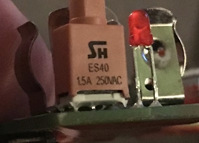

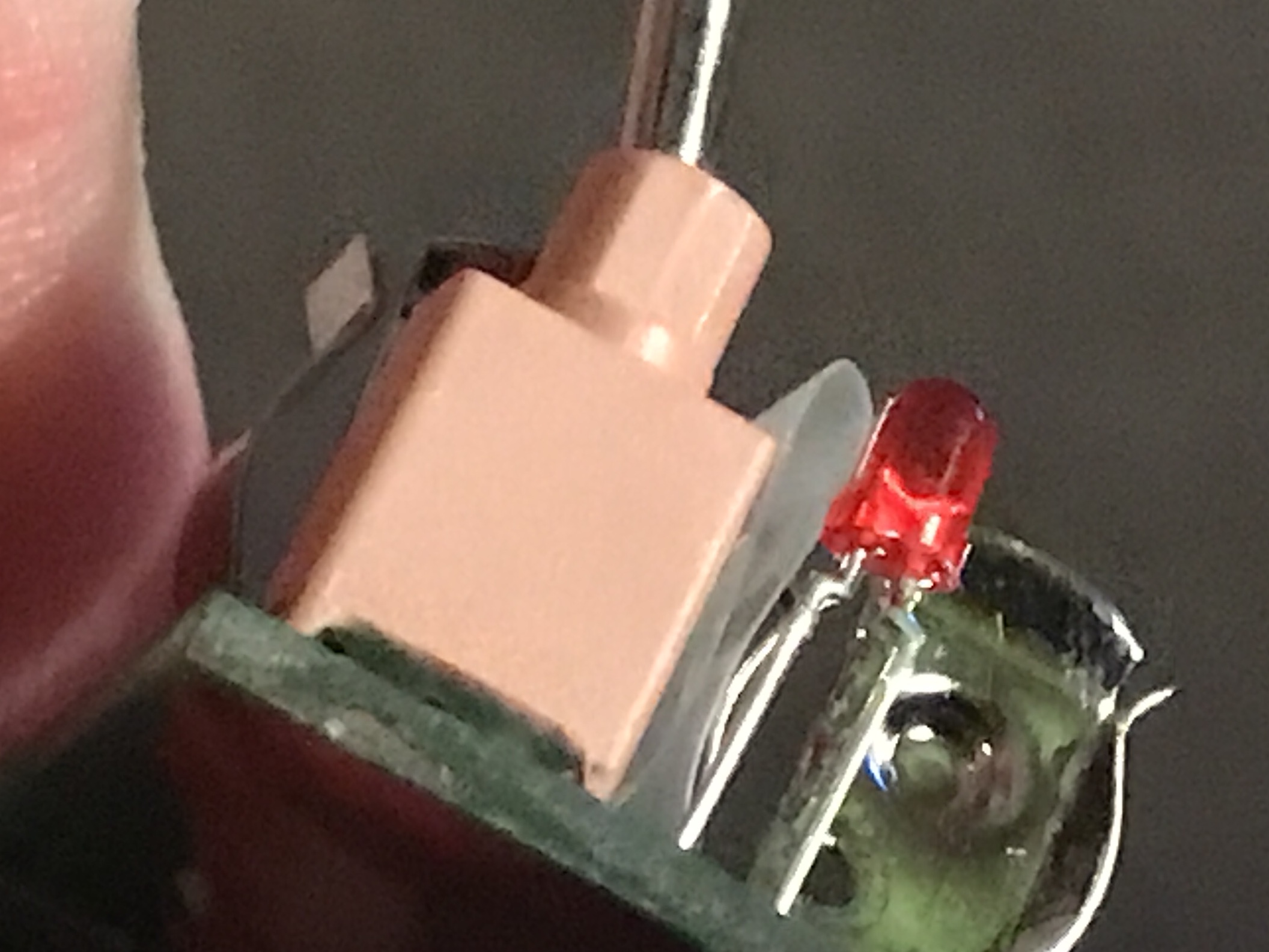

Here is a new question. One of our shooters found a way to bend the on/off switch so it no longer makes good contact. Anyone have an idea what switch to order, and solder back in place? Or, do you think soldering the existing one will work?
Posts: 3283
I took a quick look at mine (which is close to 25 years old), and it's a pretty odd part. It's smaller than most (8mm x 5 mm body, viewed from the top), with an all plastic housing and no threaded mounting sleeve. There is a stylized "S" followed by an "N" logo I've never seen before. You may have to email Morini to find out what it is & where to get one. Mine is also old enough that they may have changed parts/vendors since it was made.
There are two possibilities: 1) They damaged the switch internally, in which case solder won't fix it, or 2) they damaged to solder joint or the board traces, in which case soldering should work.
I'd get an Ohm meter with nice sharp probes, and check the switch pins directly (you may have to go in from the side, or chip off the conformal coating in that area) to see if the connection is intermittent inside the switch. If it is, the switch is a goner. It it's OK, a little more probing & gentle wiggling should help identify the bad connection on the board. I'm not sure how tough the coating is, and whether there is a risk if ripping the traces up along with the coating. The guy in India who repairs them may have a solvent that works, rather than mechanical means.

Posts: 575
Thanks...the board with the switch problem is from 2019...
We have another board from 2009 that exhibits intermittent issues...
While the parts appear the same they are definitely marked different.
We may just send them both off for repair.
Posts: 3283
The label on my switch was put on the side facing the battery holders, so I couldn't read it very well. What I thought was an "N" is an "H".
SH is apparently Chinese (no big surprise). You can buy them direct off of eBay:
https://www.ebay.com/itm/364026041609
I think the ones Morini uses have slightly shorter handles than the ones on eBay, but it's hard to tell.
Posts: 575
Hey, that is great. Those look exactly correct. Thank you.
