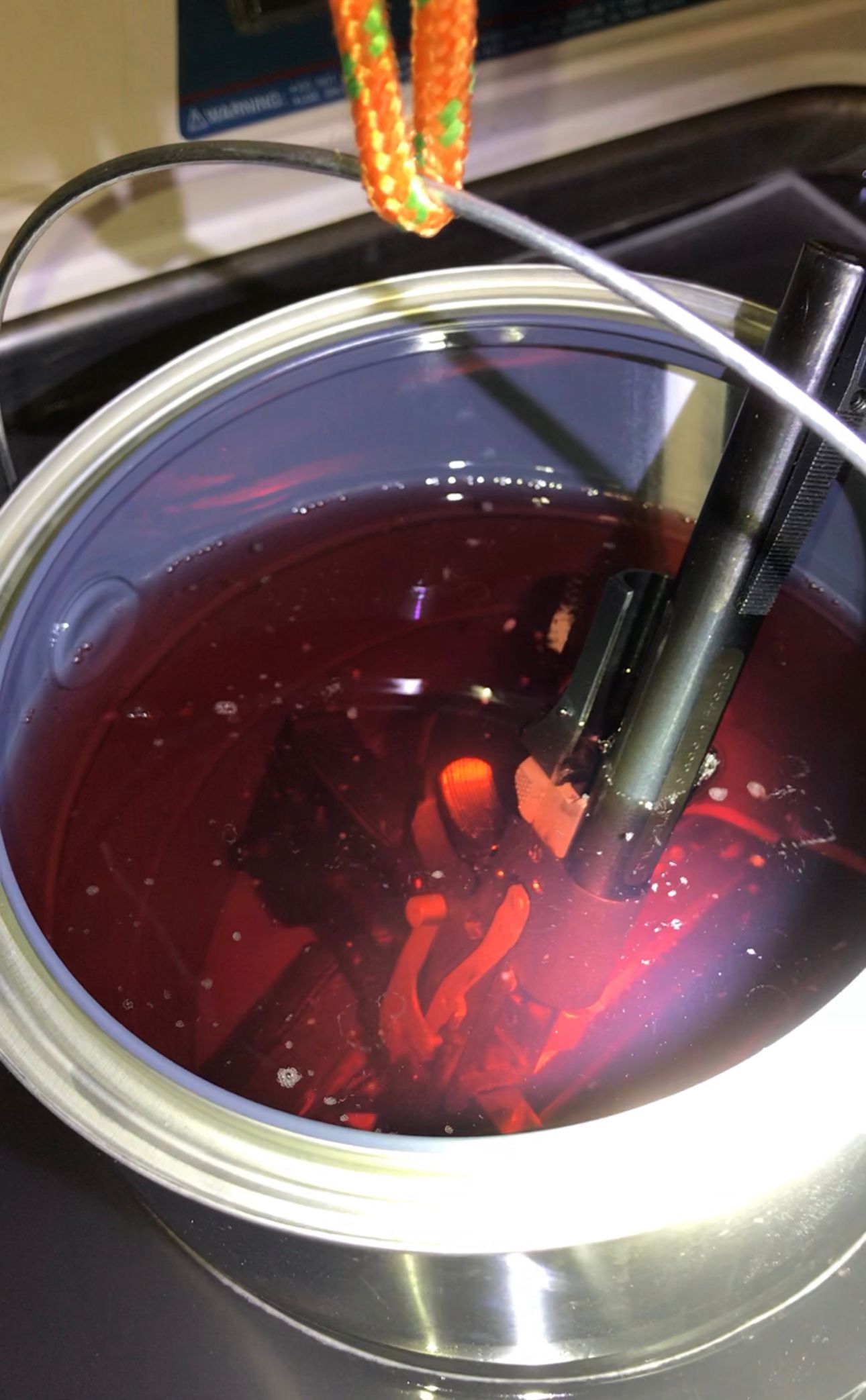

I clean guns and gun parts in ultrasonic cleaner, disassembled when possible. I have cleaned Walther GSP, Unique DES 69, Hammerli 208, revolvers, rifle bolts and more.
I do not use water with degreaser which would have some bad effects as described in earlier posts, but a mix of mineral spirit and light gun oil probably 19:1 ratio, in a secondary container that is suspended into the ultrasonic cleaner that fills with water and detergent - see the attachment for the idea. By doing this your gun won't touch water. You can change to a new solution after the first run if the particle in the solution worries you but I didn't find this necessary. After cleaning I gently blow off the excessive solutions on the parts using compressed air and let it dry. This should leave a very thin oil on the metal when the mineral spirit is vaporized, is almost dry to touch, but the oil is there and I don't find it attract more dirt than a regular cleaned gun. Then I lube the parts as needed and assemble.
I will be careful if plastic and aluminum parts are being cleaned, and of course you don't want to put painted or wooden parts into an ultrasonic cleaner.

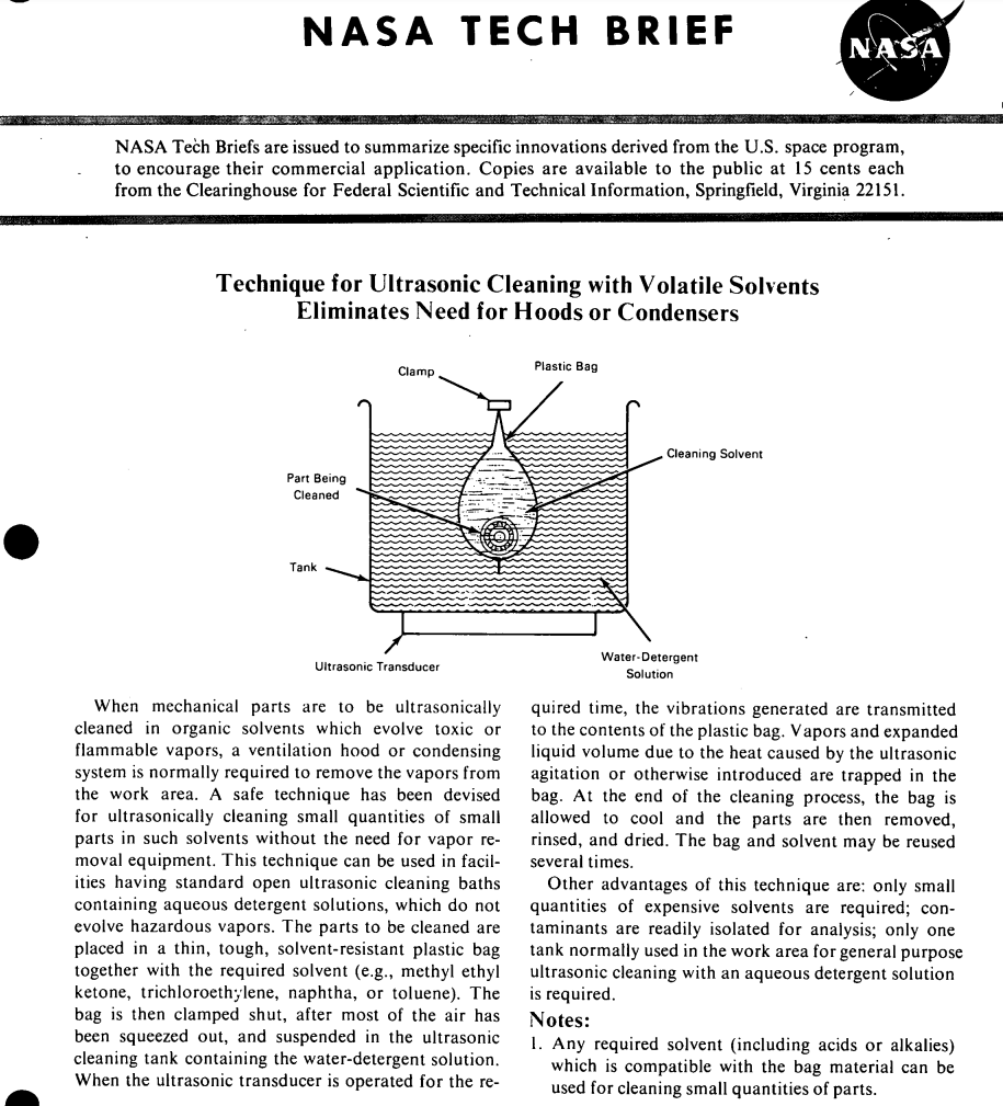

Thanks zhangtony, very good info, especially the NASA sheet.zhangtony wrote: ↑Sun Aug 20, 2023 11:09 pm I clean guns and gun parts in ultrasonic cleaner, disassembled when possible. I have cleaned Walther GSP, Unique DES 69, Hammerli 208, revolvers, rifle bolts and more.

Re: Does anyone use ultrasonic cleaner to cleaning guns?
The NASA trick with a plastic bag works OK, but the bag can dampen the ultrasonic action a bit. For small stuff, the standard approach is to use a small glass beaker suspended in the tank. They make lids with holes for the beakers, and rubber rings to help position the altitude of the beaker:

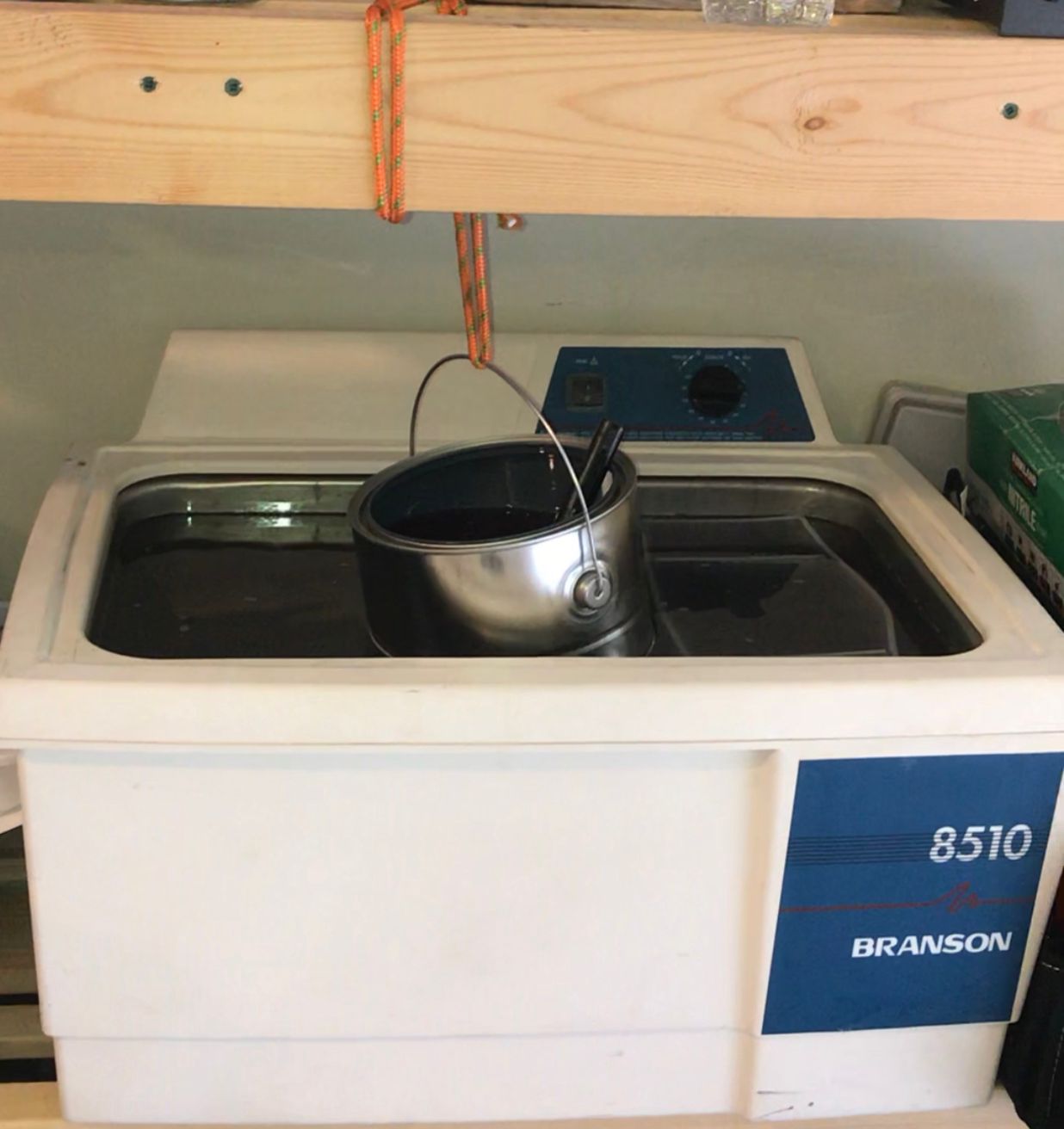

For heavier parts, a stainless steel beaker is better, so there's no chance of it breaking. The key thing is that you don't want the smaller container to touch the bottom of the tank. If you are using a solvent that could evaporate or emit fumes/odors, a rigid container with a lid is even better. I suspect a tin can with a snap on polyethylene lid would work fine.
Hi GWhite,
Thank you for pointing out the deficiencies of plastic bag. And it might leak during the wash by rubbing with parts with sharp edges. That would not be a very fun experience.
That picture was for showing the idea only, and I actually use metal buckets that is suspended in the water. The pictures show a Unique DES 69 being cleaned, with slide and magazine disassembled. You may notice the barrel is not in the solution but that does not matter too much as long as the chamber is being cleaned, and the bore will be cleaned as usual afterwards.
If I heat up the ultrasonic cleaner I will use a sealed container to prevent chemicals from evaporating from the solution. A 30 cal steel ammo can is very handy!
GWhite is also correct: By all means do not allow anything touching the bottom of the ultrasonic cleaner!
I reuse the cleaning solution by let it stay for a while so the dirts are mostly set at the bottom, carefully pour out the clear solution on the top, disregard the rest and clean the bucket.
