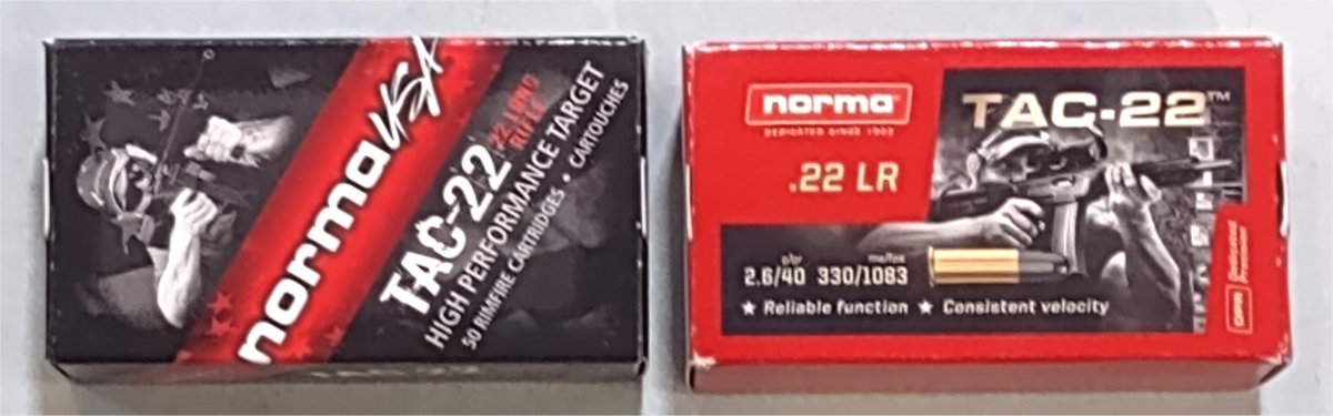

Apparently there are two flavors of Norma Tac-22 around. There is black box & red box:
The black box is older, and VERY greasy. The stuff I tried that worked really well was the red box, which has a much nicer lube. I think it's harder & thinner, so it's not nearly as messy. My guess is that it's the same basic ammo, but they got enough complaints about the lube that they changed that.
