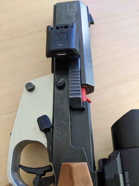

I glued a small magnet to mine, and I slap it on the side of the frame as close as possible to the trigger or sear, depending on the gun. With my Benelli, I stick it on the left side of the frame, slightly in front of the trigger module. There's a Mantis app setting for that orientation, and it works great.

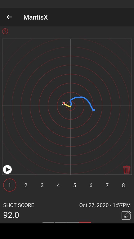

Well, blue and yellow. Blue is the pre-triggering movement, and yellow the movement just before the break. The X3 will show a red trace for post-shot movement.
Here's an old example from my history, showing a decent hold but the actual shot was out of the X-ring, looks like I might have "snatched" it a bit because the movement was smooth.

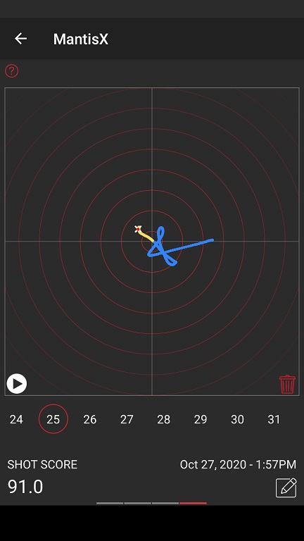

... and another one earlier in the string, showing the shot pushing left as the trigger was applied.

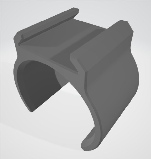

There are actually 3 STL files; one for Morini cylinders, one for Steyrs, and one for Benelli Kites. The dimensions all worked nicely on my printer, but they may not be as snug a fit when fab'd on another printer. I can provide STP files if they need serious adjusting. I use eSun PLA+ filament, with a 0.35 mm nozzle & 0.2 mm layer height. The PLA+ is stronger than regular PLA, and it's a bit more flexible, so the spring of the clips will also be material dependent.
Here's what the Steyr clip looks like:
Steyr Cylinder Mantis Clip.jpg (20.09 KiB) Viewed 1033 times

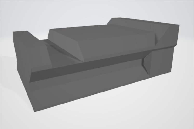

All three cylinder clips attach to a short rail that the Mantis attaches to:
Mantis AP Mount Rail.jpg (18.11 KiB) Viewed 1029 times
