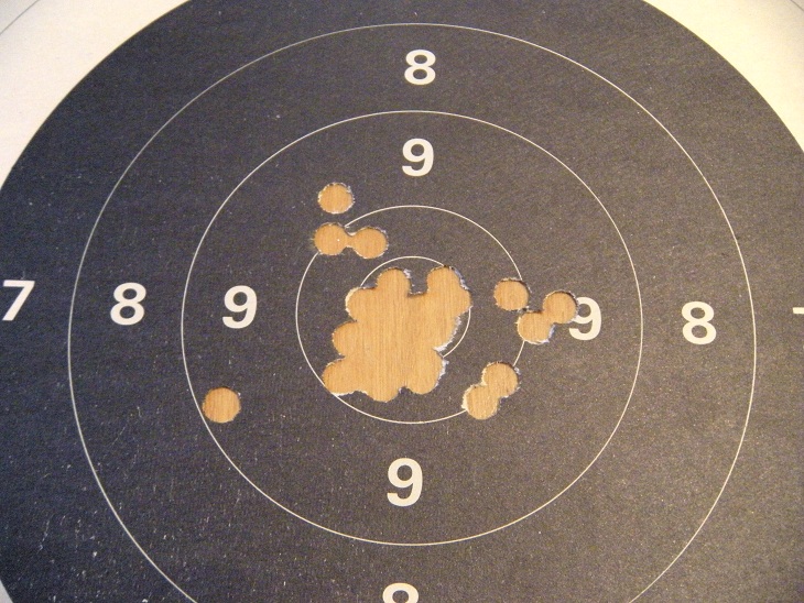

Stan
I am doing it all again for a hammarli SP20rrs ,it slugs in at .314".
Finished making a new neck sizer die at .314 (factory are .312) and using a 90g cast projectile (HBWC are nil stock at the moment) with 1.8g trailboss powder.
Trailboss gives a better case/powder density, being bulky it fills the case more and gives very consistant loads. I did have to modify the powder thrower to throw it evenly.
98g HBWC, 1.7g Trailboss, 25m with Tesro pistol free standing ISSF centrefire match.

I said I wouldn’t try again at 50 yards until I got a new barrel but I got bored and decided to try something else. I ordered some H&N .314 HBWC’s. I should have listened to Dave Wilson’s recommendation in an earlier post but I didn’t have the confidence in swaged HBWC’s like I did in the old days and the reason is because a lot of firms are now using lead that reads about 10 to 12 BHN for their swaged bullets. The H&N’s however are pure lead as it’s BHN was around 5 when I checked the box that I just bought. The whole idea of a HBWC is for it to be soft in the first place. The old Star’s that we all loved were pure lead until close to when they shut down and although I never experienced bad bullets from them, a lot of my friends complained that the bullets at the end weren’t as good as earlier.
I tried Power Pistol and Russian Unique, loading 2.0 and 2.2 of the power pistol and 1.7 and 1.8 of the Russian. I got excellent groups but bad flyers like I so often got before. This time I watched each shot and kept track of the brass that made the bad shot. I was looking for a different inside diameter thinking this was swaging the bullet down but found out that the problem was more simple than that. The Lapua cases I was using were all different length. Then I went and checked some new cases and they vary around .004. The used cased were as bad as .006 different. After trimming all the cases to the recommended length and shooting the same loads again, I got all four loads to shoot 10 shots in from 2 1/8 to 2 ½ inches center to center at 50 yards. I have to go load up some more and try it again because I have many times gotten 1, 10 shot group to look promising making me think I knew what I was doing and then come back and it not be so good especially counting flyers. This may have been from accidently picking cases that were close to all the same length and the next time getting the odd ones but this time all four groups were good with no flyers. Most of the time when I got a decent group I was using CBC brass and I went and checked them and most were close to the correct length compared to the Lapua group. This is the first time I have had a problem with straight wall pistol brass. I ignore 38’s, 45’s and 9mm and can get excellent groups with mixed brass. It seems that it is certainly a persnickety caliber. I’ll still try the new barrel when it comes in to see if it is even more accurate but I am satisfied if it will do this consistently. My friends are all going to trim their brass and try some of my H&N’s to pin this down even more. When they report back, I’ll post if it made a difference. Bear in mind that it is necessary to resize before you measure or trim because it makes quite a difference in length.

oldcaster wrote:The Lapua cases I was using were all different length. Then I went and checked some new cases and they vary around .004.
That's interesting. While trying to eliminate the flyer issue with my HP (which IMO is more related to bullet diameter vs. bore diameter than anything else), I standardized everything I could in the reloading process. Included in this was the brass selection.
After carefully weighing and measuring multiple brands of .32 brass, I selected Lapua. It was far more dimensionally consistent than any other brand of brass I could find.
BTW, one thing to be sure of is to slug your barrel with a soft slug of lead or soft swaged bullet. Do not use a hard cast bullet for checking the bore diameter. It will not give you a true measurement.
Once you know the bore diameter, a swaged HBWC .001 larger than the bore diameter should perform well.
Stan

I do use a large homemade expander that is just a bit longer and thicker than a 100 grain HBWC so it is possible that my good experience is somewhat due to not swaging down the soft bullet as it is inserted into the case however I had flyers with everything until I trimmed. I even shot some water dropped molded bullets, so they would be real hard, to bypass this possibility. My Benelli barrel is .3135, and my expander is .3132 and the H&N bullets are .3142 in the front and about .3138 in the rear with the lube wiped off, but when we get that technical we would have to compare micrometers before those measurements are taken to heart. The difference between all the measurements is what counts. Also the skirt measurement isn't real accurate because it isn't perfectly round. They are very soft and the skirt could get out of round easily but I don't see this as a problem as long as it isn't real obvious to the naked eye. It will be more interesting to see what results my friends get when they trim and use the H&N HBWC. None of them have an oversize expander.
I believe that the flyer in .32 is caused by case neck release tension giving variations in velocity and timing of release of the projectile from the case.
If you mix your cases, not only can they be different sizes, but different wall thickness and brass stiffness.
Batch to brand, age and number of reloads , then check trim length.
For a big competition I will only use new brass, regional comps 2 to 3 times reloaded and club/training all old reloads.
